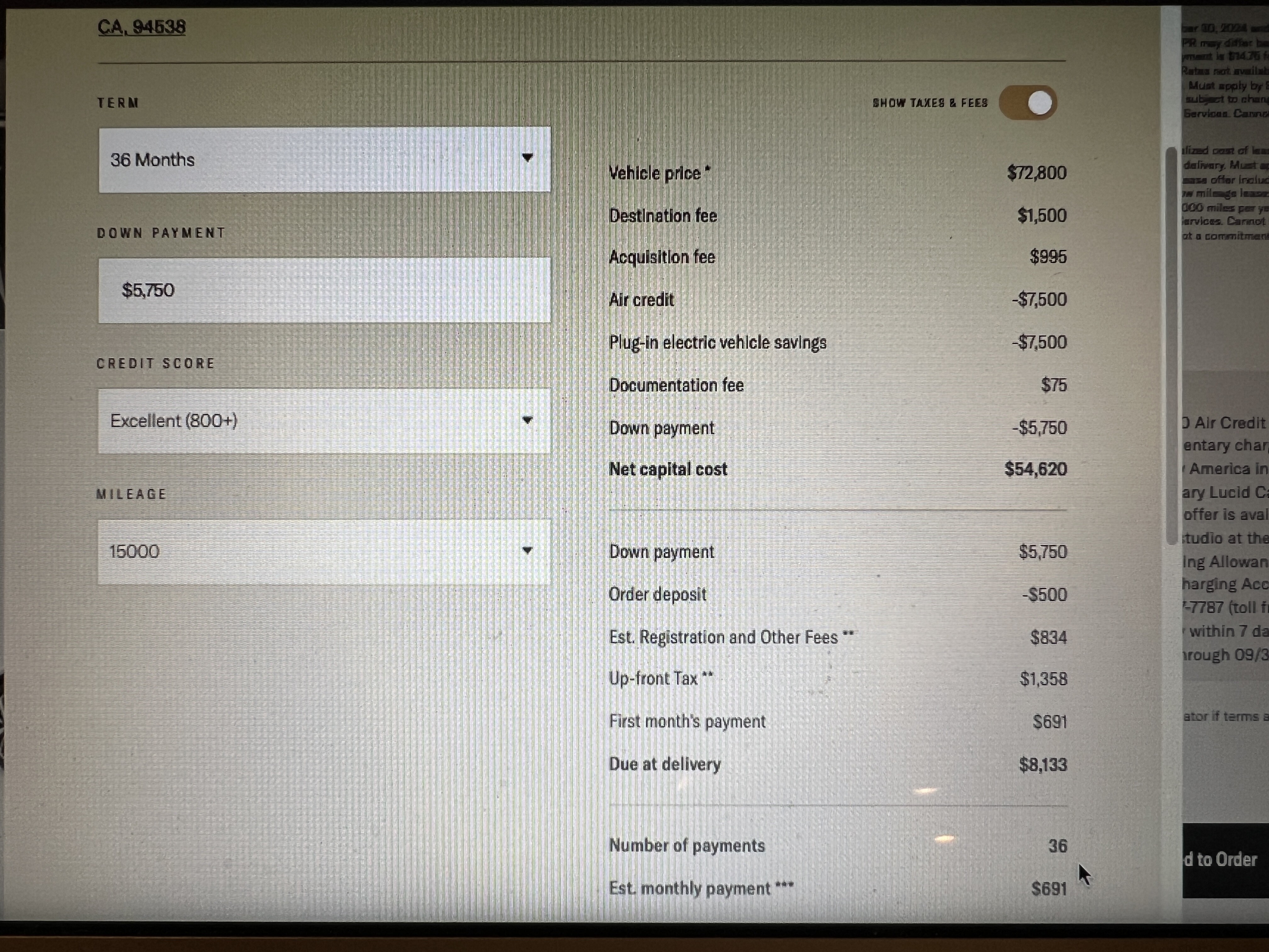

Lucid website calculator, original screenshot. In the downpayment field, we used the value of $5,750 to simulate the $5k onsite credit and the $750 referral credit to make the calculator output a monthly payment estimate.
