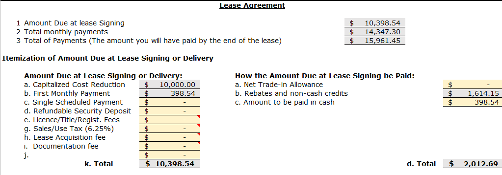

Understand the math and how it will be shown on your lease agreement (see example attached). Understanding the lease agreement is important since this is what you will see when its time to sign it. If you understand it, you will be able to identify what doesn’t look right during signing time.
