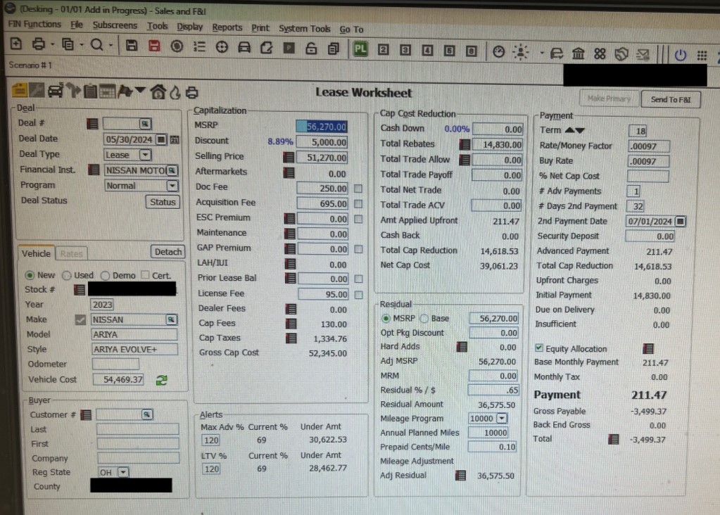

SIGNED: 2023 Nissan Ariya Evolve+ AWD | MSRP $56,270 | 18/10k | $211/mo
I was close to signing for a 2024 nearly $500/mo effective, but thanks to some encouragement from the Hackrs, I dug in and found a 2023 within driving distance.
Contacted dealer and was able to make the deal same-day. Minimal resistance to the pre-incentive discount once I told him what I was looking for (did not bring up lease incentives until after he agreed on ~9% off MSRP)
Calc Link (close as I could get it): Leasehackr Calculator - Hack your next lease | Leasehackr
MSRP: $56,270
Dealer Discount: $5,000 (8.9%)
Sale Price: $51,270
Incentives: $14,830 (EV + 18mo Lease + 23Ariya Bonus + Loyalty + partial dealer cash)
RV: 65%
MF: 0.00097
Monthly Payment: $211.47
1st month up front
Screenshot from dealer attached
The car is great so far… huge improvement from the other Nissans I have had. Would recommend anyone in the market look for these 23s still around!

Question for OP. I’m new to this Lease Hackr situation and I have a question. I saw that your gross payable is negative, does that mean that basically you got a free lease (if I’m understanding correctly)? My nearby dealer has one for around $60k minus $7k in ā€œsavingsā€ minus $2k in customer bonus (which I don’t know if it applies to leases) for a total pre-tax price of $51k.
Not going to claim to be an expert, but the short answer is that it isn’t negative.
There is a bit of a formula behind it, but even in the dealer calc you can see the Net Cap Cost @ $39K and then Residual Value at $36.5K. The depreciation portion of the lease is charge on that gap (please someone chime in if I am off).
I found this post from @delta737h which was helpful with Ohio-specific calculations since the taxes seem to cause me some trouble in my calculator. Leasing in Ohio - #6 by delta737h
I’d be wary of your dealer advertisement including the incentive programs are part of the ā€˜sale’ price. You need to make sure you have a clear understanding of their selling price pre incentives and rebates (see my calc in the 1st post).
ā€œGross payableā€ on that screen is some BS definition of the dealer’s profit. It’s not something you ever need to pay attention to.
And it’s not a free lease. It’s $211 x 18 months
IDK if you’re imagining a check being paid to the OP in the amount of the gross payable which would make it basically a free lease.
Oh yeah I see where they may have been looking.
Right that ā€œGross Payableā€ is how they try to ā€˜prove’ to you that they are losing money on the deal. If they really lost $3500 on this car, do you think they would have sold it to me? Did they desperately need that one parking spot? Is their inventory holding cost so high? yet somehow they were happy to do the deal…
NOPE.
I think you can do a little better,
Using the hard data provided by you and the dealer, I’ve re-structured the lease as follows…
MSRP 56270.00
Sell Price 51270.00 (8.9% discount… you can do better)
Acq. Fee 695.00 (taxable)
Dealer Doc Fee 250.00 (taxable)
Capped Fees 130.00 Need to itemize- will treat as taxable for time being
Gross Base 52345.00
License 95.00 (non-taxable)
Gross Cap 52440.00
CCR 13463.04
Net Cap 38976.96
MF .00097
Term 18
Residual Factor 65%
RV 36575.50
Sales Tax Rate 8.00%
Base Payment 201.33
Contractual Payment 206.70
Lease Inception Fees
1st payment 206.70
Payment Tax @8.00% 289.92 (201.33 x 18 x 8.00%)
CCR 13463.04
CCR Tax @8.00% 1077.04
Total Lease Inception Fess 15036.70
Rebates/Credits 14830.00
DAS 206.70
Bottom line: 18 payments of 206.70 each.
??? Let me know.
It’s a signed deal.
Yeah, I saw that. How about… could have done better. People really need to learn how to crunch numbers. Too many allow the dealer to control the deal and are satisfied to go along for the ride. Just by restructuring, I was able to reduce OP’s payment by $5.
IMO theres a lot more low-hanging fruit where people can save a lot more than $5 x 18
That’s only for the OP’s lease… not a big deal. However, I think the sell price should have been negotiated… say 12% off or more. What other low-hanging fruit do you have in mind?
EDIT: The goal is to structure the lease in such a way that it minimizes the total cost for the lessee.
He was about to sign for $500 and ended up at $211 Would pushing for $206.70 have been worth it? Probably not.
