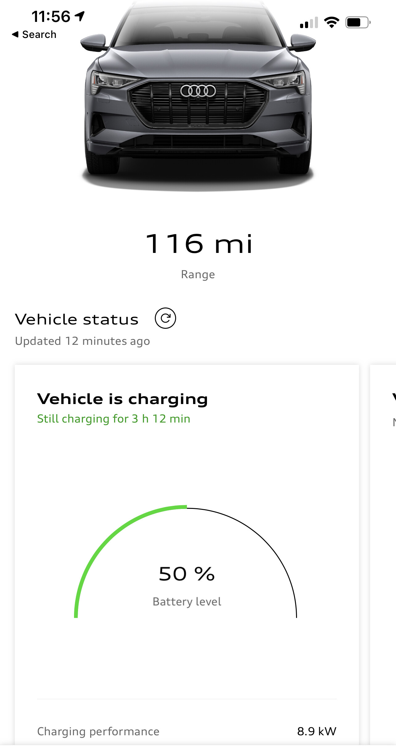

I’m jealous of your 10x charging speed
Oh wow. Yeah I’m going to get a couple more quotes for sure. I have the charging unit just sitting here, but I’m not in a super rush.
