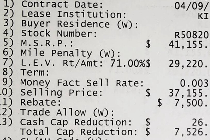

First lease. Feeling green, but grateful for all the wisdom here. Would love some feedback, what to ask for from here:
Kia Niro EV Wind 24
MSRP: 41,155
LEV Rt/Amt: 71% 29200.05
Term: 24
Money Rate: .00312
Selling: 37,155
Rebate: 7,500
Cash cap reduction: 26.05
Total cap reduction: 7526.05
Capped fees: 425
Tax total: 1,247.87
Adjusted Cap Cost: 30,053.95

I can’t get the calculator to perfectly match the fee detail they shared here, but I’m close…

This is as close as I can get using the LH Calc…
I don’t like using online calculators preferring, instead, to use my own lease calculator programs. Although, the LH calculator is by far the best online calculator I’ve seen. Why isn’t the 650-acquisition fee taxed? In the LH calc, I had to include it in gov fees to avoid taxation. The residual is 29220.05, not 29200.05. Res factor = 71%. You may want to try to do the calculations manually so you can learn more about leasing. You may want to read the below pdf written by yours truly.

EDIT: Why are they collecting an additional 26.05 from you and using it as a CCR? It’s unnecessary.

Yeah no idea what’s going on with the 26? Anyone recognize what’s happening here?
Oh… That seems like such a small drop. Might want to check what buy rate MF is for 36 mo. The $7500 is more impactful in a 24-mo lease, but maybe do the math btw 24 vs. 36 mo to see what works better for you and your situation.
There is no justification for it other than to lower your payment by 1.83. A DAS = 0, would mean…
CCR 5906.33
CCR Tax 575.86
1st payment 321.56
Waste Tire 11.25
Acq Fee 650.00
Rec 13.00
Title 18.00 (your original post shows 18, not 18.50)
Temp Tag 4.00
TOTAL 7500.00
Rebate 7500.00
DAS 0.00
MF = .00312 which is about 7.49%
