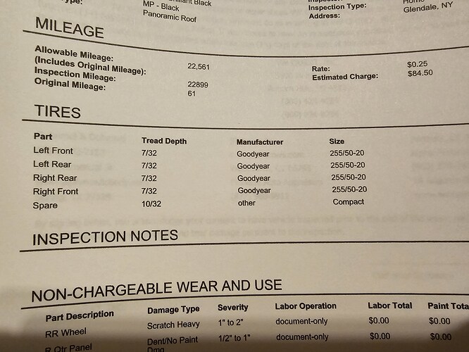

I just had an inspection done with 22,900 miles and tread depth came in a 7/32. No penalty.
