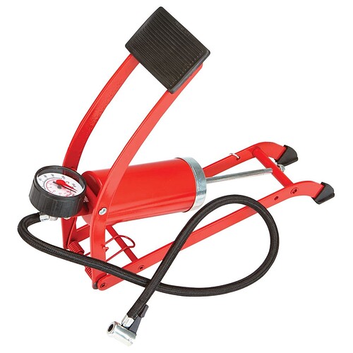

That’s basically what they have at the nearby Chevron station. :dash:
