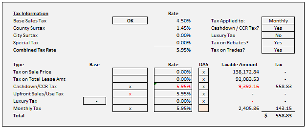

The 1892.16 is a portion of the 5000 DAS used as a cap reduction that results in a decrease in your monthly payment. The balance is used to pay for the remaining lease inception fees (see below).
Tax is levied as follows…
5.95% x (7500 + 1892.16) = 558.83 and is paid upfront (see below). The tax amounts of 701.98 and 743.75 are BS and is not used in any of the lease calculations. The only tax used is 558.83.

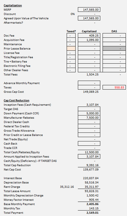

Here is how your lease is structured…
MSRP 147565.00
Sell Price 147565.00 … No DEALER discount? That’s horse shit!
Acq Fee 1095.00
Dealer Fee 409.25
Gross Cap 149069.25
CCR/Rebate 7500.00
CCR/Cash 1892.16
Adj. Cap 139677.09
RV (55%) 81160.75
MF .00410
Term 39
Base Pmt = .00410 x (139677.09 + 81160.09) + (139677.09 - 81160.09)/39
= 2405.86
Contract Pmt = 2405.86 x 1.0595
= 2549.01
Lease Inception Fees
Cash CCR 1892.16
Sales Tax 558.83
1st Pmt 2549.01
DAS 5000.00
Bottom line: DAS = 5000 followed by 38 monthly payments of 2549.01 each.

The Cash CCR is calculated. If you’re interested, I can provide you with the formula developed by yours truly as well as all other manual calculations.
Also, the LH calc provides…
The only change from yours is that the down payment is 1892.16, not 5000.
??? Let me know.

I hate the dealertrack portal for this exact reason. The only money down is the $1892- included in the total of 5k. The taxes calculated are wrong and it doesn’t disclose monthly taxes. This is the #1 reason consumers dislike dealers - they are deceiving and non transparent.
I couldn’t agree more! They actually calculated tax on the 5000… unbelievable! The 5000 is DAS.
I don’t think you are understanding some basic leasing concepts…‘down’ vs DAS (due at signing, 5000) are not the same thing…and reductions to cap are in fact generally taxed.

For others, here’s a different way of looking at the breakdown vs John’s post.
In Oklahoma, Cap reduction/cash and Rebates are taxed. The dealer is making it simple by telling you your tax bill is $743.75, 5.95% of your $12,500 in cap reduction (7,500 rebate and 5,000 cash).
However, he fails to indicate that some of that cap reduction is being applied to your inception fees. In this case, the first monthly payment of $2,549.01 and $558.83 in taxes – $3,107.94 in total – reduce your total cap reduction from $12,500 to $9,392.16 (which in turn is your taxable CCR amount, on which you multiply the tax rate to arrive at the correct tax amount of $558.83)
Because math is so (literally) neat, the difference between $743.75 and $558.83 is $184.92, which is 5.95% of your inception fees ($3,107.94)
As for where he pulls the $701.98, I haven’t the slightest clue! (nor does he apparently)
