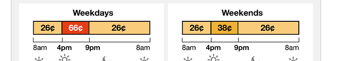

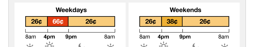

I’m using EV-TOU-5 in San Diego (Carlsbad, CA). There is a $16/mo service fee, but rates are 15.4cents per kw. I charge the car, run the pool pump, run the dishwasher, and when it gets hot, I set the AC at 68 degrees during off-peak Everything is on a timer. I think I calculated my cost at around $30/mo for the EV.
We spend about $200/mo on electricity because no one else cares about peak rates so they just do their laundry after 2pm when the rates go to 81.6 cents per kw. During the pandemic, we heated our pool every day so our gas bill was over $1000/mo.
https://www.sdge.com/residential/pricing-plans/about-our-pricing-plans/electric-vehicle-plans

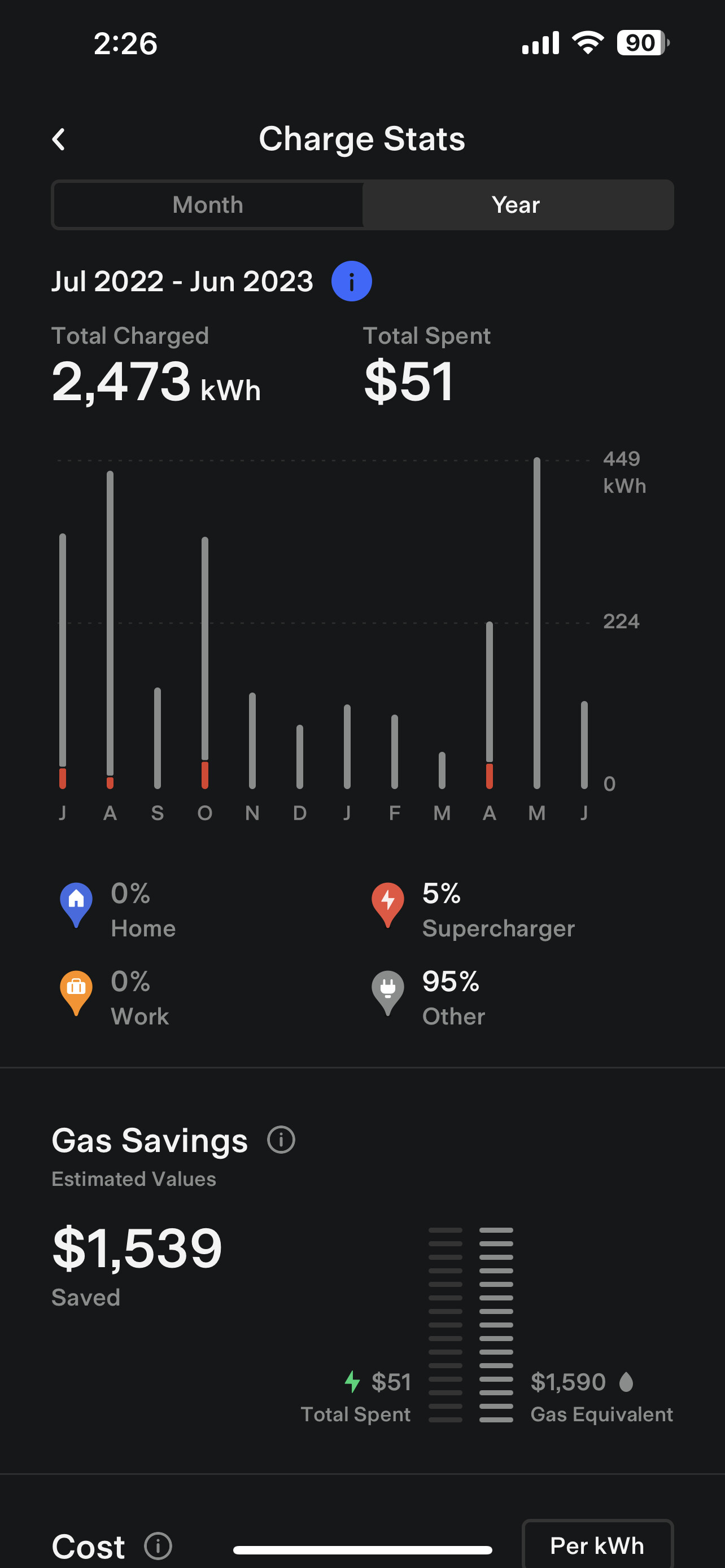

My 1 year ownership of the Tesla Y and my ONLY cost is $51 at Superchargers while traveling to Vegas, the rest is completely FREE charging :+1: it’s been like this since I bought my first Model 3 in 2020 with minimal cost for charging my EV’s. I don’t charge at home, but if I did SCE rates are $0.21 to $0.27/kwh for me…
