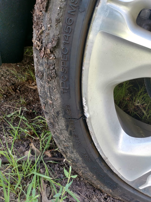

This afternoon my spouse was driving our Chevy Cruze in busy street of central NJ within speed limit, which is 30 MPH.
Unexpected pothole on the street caused a sudden impact causing both passenger side tires cracked open (literally cracked open) Tire photos attached.
Thankfully damage was only limited to the car. GM roadside and towed the car to nearest Chevy dealer. Meanwhile, I also called Michelin and explained what happened.
Considering it’s a brand-new car at only 11K miles, I didn’t anticipate tires to give up so easily in normal driving scenario. (potholes are very common in NJ)
Dealer came back with an estimate of $1500 saying 2 tires and labor ($450), 2 alloys wheels and core ($900) + alignment ($100) + Taxes. This seems to be ridiculously high for a car which will be returned in just a few months.

What damage was done to the wheels? You may be able to have those repaired. And I would certainly not oay $450 for 2 tires. Hell, you can get all 4 cheapo tires for less, most likely.
My understanding is wheels aren’t damaged much.

Tire brand doesn’t matter. As long as the size matches and the speed rating meets or exceeds OEM, you’ll be fine. Keep the same branded tires on front and same branded tires on rear if you’re only replacing 2. In other words, don’t put a Michelin and a Goodyear on the front at the same time.
If you do decide to go used, keep in mind your tires need 4/32 of tread life remaining at the end of the lease without excessive wear charges. Buy something with enough meat left to get you to the end.

The tire held up, but had a bubble on the sidewall.
Not sure if the “curbing” is from the pot hole or previous damage but you will be on the hook to fix that either way. A mobile wheel repair guy will cost you about a $100 a rim. You can get them refurbished all day long from sellers on ebay for just a bit more including shipping.
