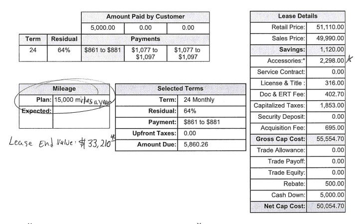

I’m on a L1A visa, recent to USA, so no cred record. Therefore need to utilize the foreign executive lease program offerd. Ford has that.
Based on that I got an offer from a dealer close to Chicago for a new 2024 F-150 XL.
Need help to see if this is a good deal or not, AND what to focus on to negotiate down if needed.
Thanks!
You paid more than 50% of a car’s value to drive it 2 years…

That’s a crazy payment for a fairly barebones truck. I guess recommendations depend on how long you’re here and your POV on spending vs saving while here.
Are you here possibly permanently and planning to save for things like buying a house, etc? Or is this basically an extended vacation?
I helped a relative go through the same process a couple of years ago and the conclusion was that they help with not having credit history but are still costly. If you are here for a few years or more, buy a nice used car and try to pay it off quickly.

Thanks all, I suspected the offer was too outrageous. You’ve confirmed it based on the responses (btw, I havent signed this deal as mentioned for those of you that jumped to ‘you crazy man’ mode..)
I didnt pay nothing… asking for advice about this kinda deal and what specifics about this deal to focus on to negotiate down?
Can you perhaps point me to something concrete about this deal that is absurd? Ie. Residual value, interest paid, asking price, etc?
Post a calc link.
Paying 50% of the car’s value for driving it for 2 years is already very “concrete”.
