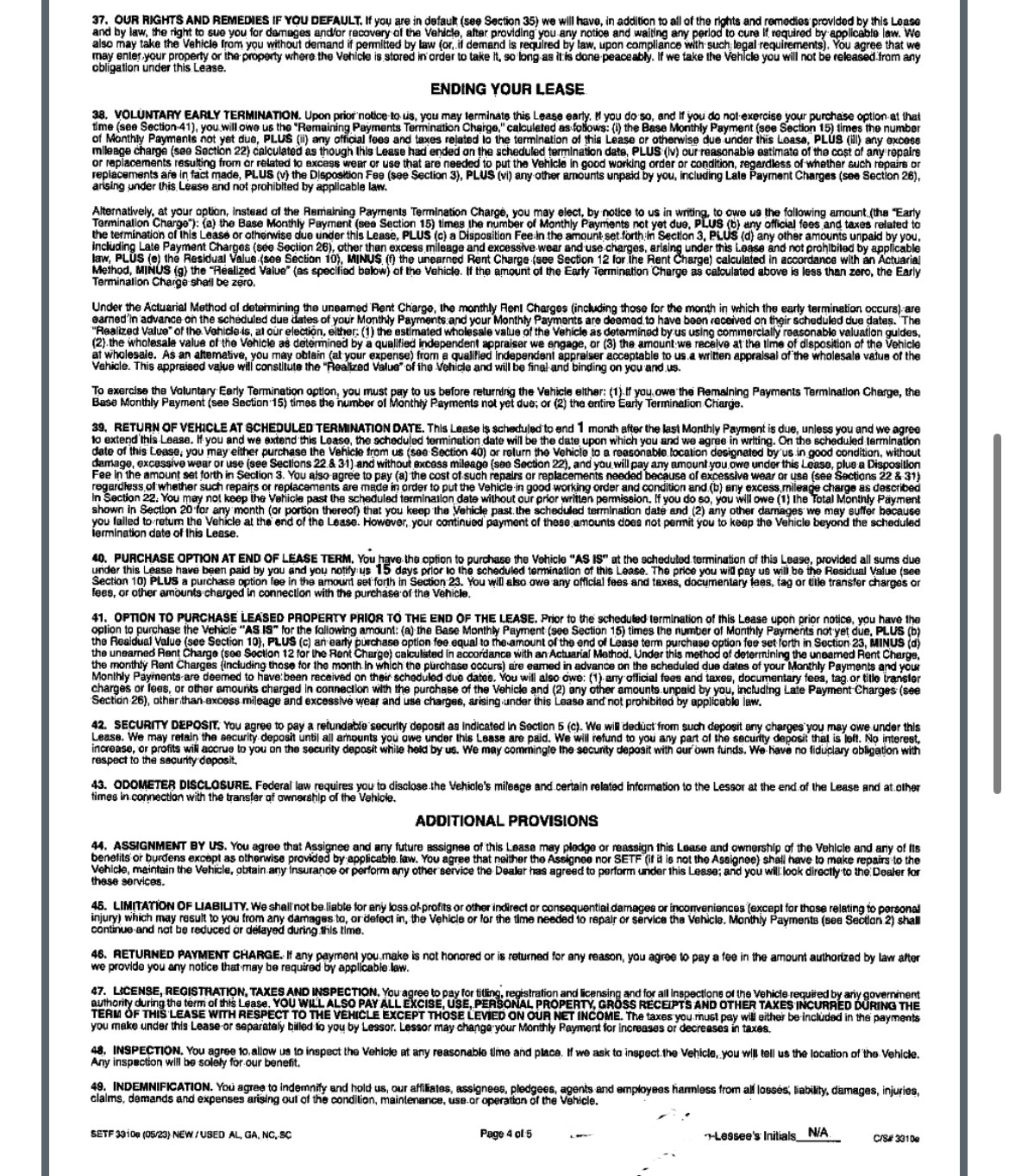

Read my paperwork today and SETF mentions in there contract terms that early termination could result in the fee of “thousands” was the wording - not sure what that is referring to? Remaining payments or some BS early lease end fee they cook up. Called and spoke to four different representatives from SETF over two days and nobody knew anything

You need to post the first 3 pages of your lease contract (including the itemization of the gross capitalized cost) and the section that addresses early termination and how the adjusted lease balance is calculated. Can’t advise or do a thorough analysis without this information.

A few Toyota dealers offered 32-33k, and a few refused to offer anything here in Ct because they don’t want to deal with setf. Ill post the contract

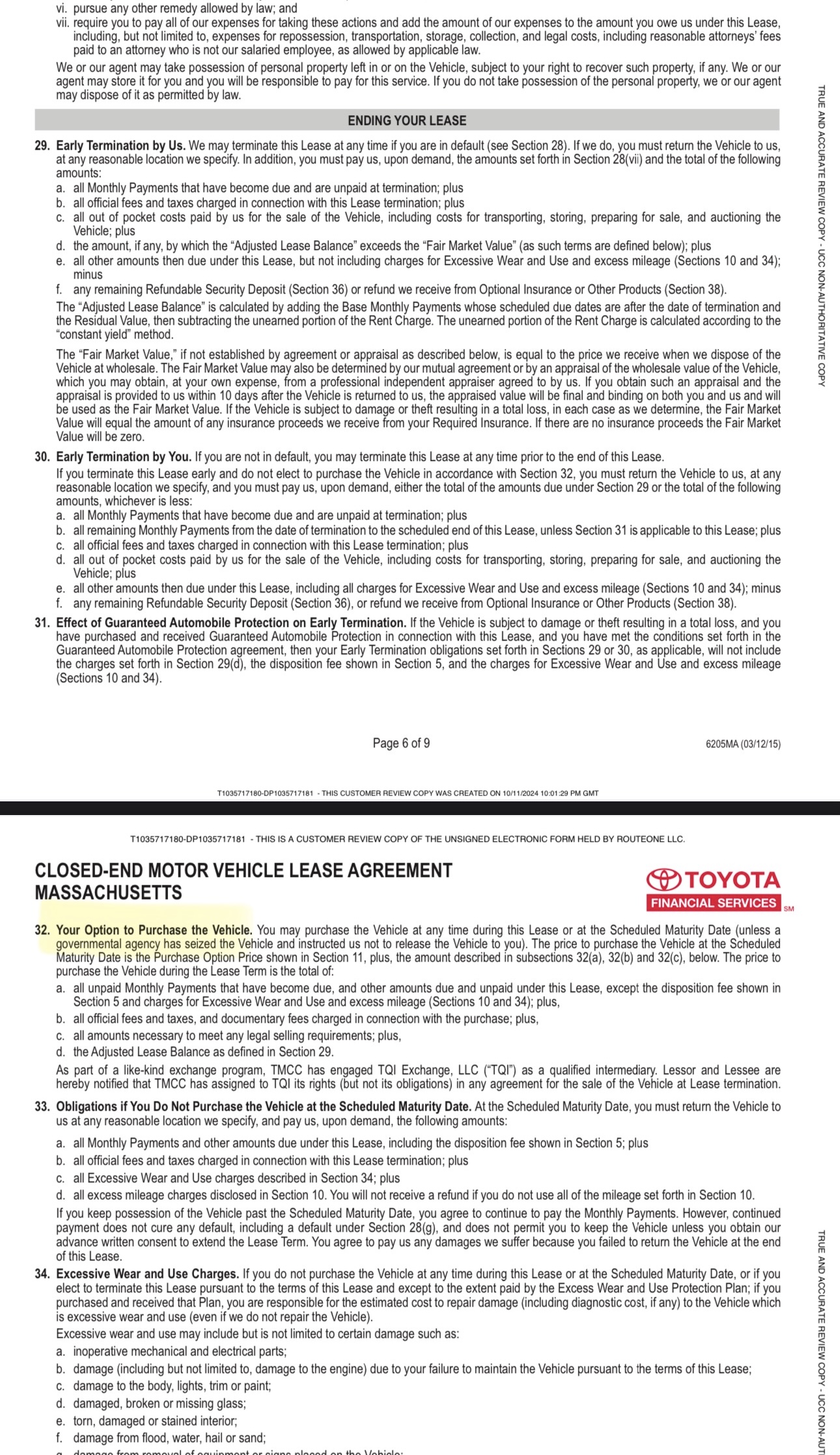

My TFS lease says the same between section 9 and 10, but spells it out in section 32. What does your contract say in “ending your lease”?
