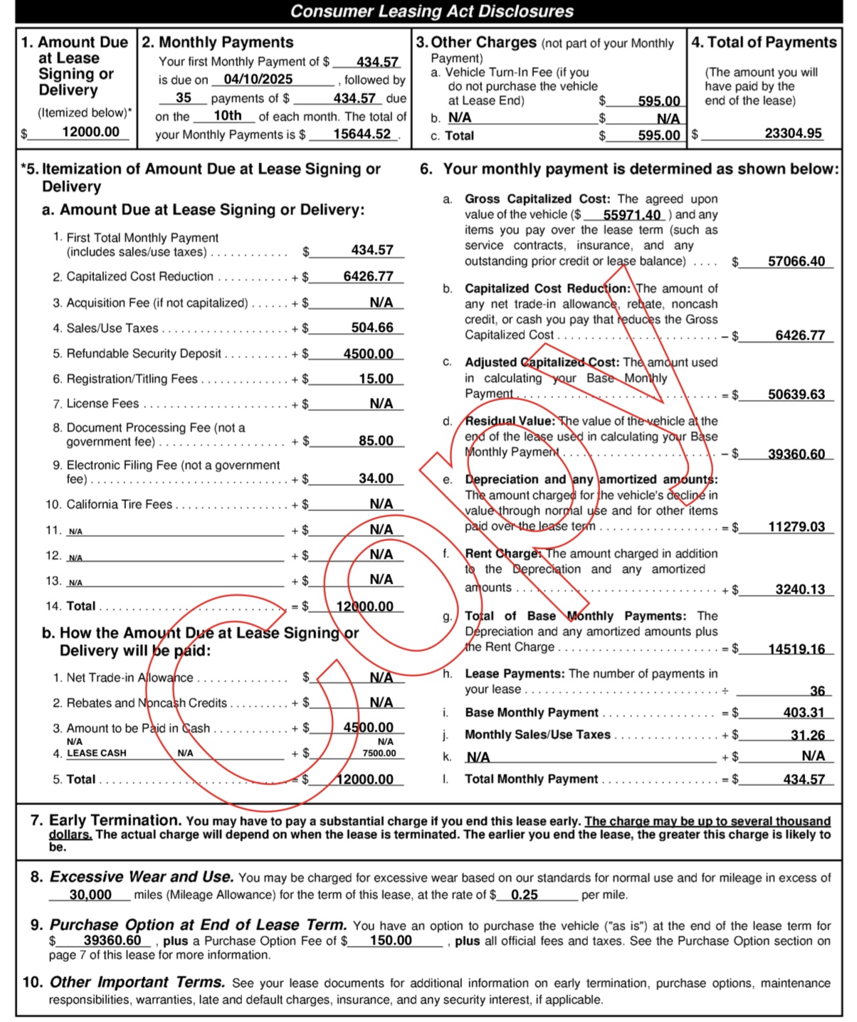

My best attempt:
This is great feedback & you are correct … I did so $4,500 in MSD so it’s not technically a $0 drive off. This car is in California so I believe the tax rate is 7.5%.
I’d greatly appreciate it if you could take a try at a calculator? I’m beginning to think the deal wasn’t all that great based on all of the errors you are finding with the financials. Here is my best attempt at the LH Calculator which is wrong:
They already signed the deal and are trying to replicate it in the calculator for others to see in the Signed! section.
Here is my
LH Calc
Note that here is 7500 of lease cash. A portion (6432) is used as a CCR and the balance (1068) is used to pay all upfront fees excluding MSD’s. The 6432 is a number that must be calculated. The LH calculator cannot perform this calculation unless you do rial and error or guess and check.
According to m LH calc, you owe 3500 MSD’s at signing following by 35 payments of 445 each. I have not verified these calculations manually.
I manually confirmed the most recent lease contract calculations, and they are correct. The dealer used a sales tax rate of 7.75%. OP will need to verify. Not sure how MSD.s should be calculated. The LH calc shows 9 MSD’s for a total of 4500 suggesting that the payment is rounded up to the next whole 100. Dealer may have done the same OR, rounded up the payment to the next whole 50 triggering 10 MSD’s for a total of 4500.
Here is the LH Calc
The 7500 lease cash is allocated as follows:
6426.77 is used as a CCR. The 1073.23 balance is used to cover all upfront fees…
1st Pay … 434.57
CCR Tax… 498.07 … 7.75% x 6426.77
Doc Fee… 85.00
Doc Fee Tax…6.59
EFF… 34.00
Gov… 15.00
TOTAL… 1073.23
Lease Cash Credit… 1073.23
DAS… 0.00
Bottom line: DAS = 0 + 4500 (9 or 10 MSD’s) followed by 35 monthly payments of 434.57 each.
