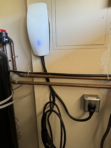

Just random level 2 chargers off Amazon that fit my cars. I manually ran wires from my panel to my garage and installed the outlets on a pillar.

Hard-wired only – unless you make 14-50 plug yourself and in-turn connect the (hard/stripped) wires from one end to the EVBox charger unit, and use the plug to plug into 14-50. On 14-50 plug, however its good to limit upper limit of charging to 40 AMPs (80% sustained off 50 Amps peak).
We’ve had 14-60 circuit & wiring (and breaker) installed previously, so, we simply un-wired the plug, and instead put this EVBox (free with our lease from late-Feb 2024) on those hard-wires (end-to-end 60 Amps). The EVBox limits you upto 48 Amps max-sustained charge – and we set it at that max limit.
Funny thing is our Tesla charges at 11.6 kWh faster speed, while this MB charger and EQS limits themselves to 9.6 kWh speed on this charger. (** we had to put small $20 adapter on this charger - to get-it/convert it into NEMA/Tesla type …)
I just use a 14-50 plug and hardwire it to a hardwired charging box for installing my charger, as I already have the plug in my garage. It’s super easy to do, just buy a dryer plug off of home depot.
Ack - our intent was to get the full of sustained 48 amps charging speed on our 60-Amps circuit/breaker - while at it.
With the $20 NEMA adapter, we are now charging Tesla at 11.6 kWh sustained … (making use of the full 48 amps on 60-amp end-to-end circuit/breaker).
For us hard-wiring enhanced charging (monitoring, and higher speeds) on both EQS and Tesla Model-Y. Hence …
Hey thanks. Can you send me a link (and if possible a tutorial lol) on what you bought and how you got that done? Im thinking of just getting Chargepoint to make it simpler.
i heard this month
This was what I got - https://www.amazon.com/gp/product/B0002YURAW
Thanks! Is that easy to connect? Do you have a picutre any chance of your setup?
My setup - pretty sure there’s some images online of how wires are connected internally.
There’s a tutorial on this:
