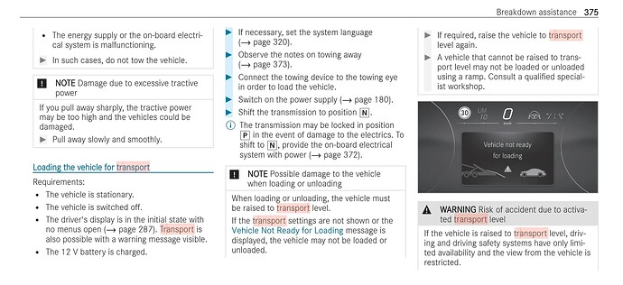

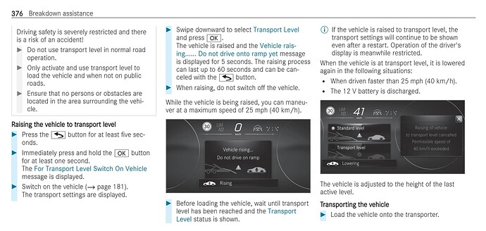

Maybe this would help? Might be too much of a pain every time?
I wouldn’t do that tbh. You mess with the safety features, transport mode might also mess with he drivetrain.
I mean they are using this mode for getting these on and off trailers at the dealerships so I would guess it’s safe as long as it’s only being used at low speeds. It seems like using this to pull into a sloped driveway would be exactly what it’s for. You just can’t forget to take it out of transport mode.
