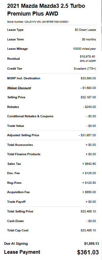

$361.03 payment = Mazda 3 Sedan Premium Plus (.00001 56%, $240 lease cash)

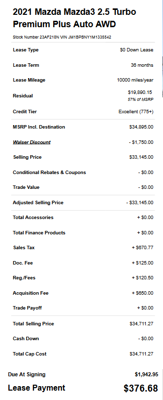

$376.68 payment = Mazda 3 Hatch Turbo Premium Plus (.00016 57%)

You need to find out what MF they are using. That third one, for example, which vehicle is that? Which MF should it be using. It has $10k depreciation and $1450 in taxes and fees. They are asking for all taxes and fees plus first month yet still show $301/mo. If that is, for example, the model with .00001 MF, there is no way there would be $24 in rent charge.
I stated above which monthly payment total equates to which model as they didn’t state it on each sheet.
Is there a way to work backwards to figure out their MF?
Yes, but not with the info you have. Asking the dealer is the fastest/easiest way. If they won’t be transparent, do you really want to do business with them? Move on, there’s plenty of Mazda dealers. And you may want to do more research on LH… GLWT
Ah, OK. Actually, yes, you have plenty. Plug it all into the calculator with the MF you are aware of and see if it works.

Here is the sedan:
So it all adds up. 10.1% discount on a mazda seems really good to me but I haven’t researched them. Lack of incentives and just an OK MF kill it.
