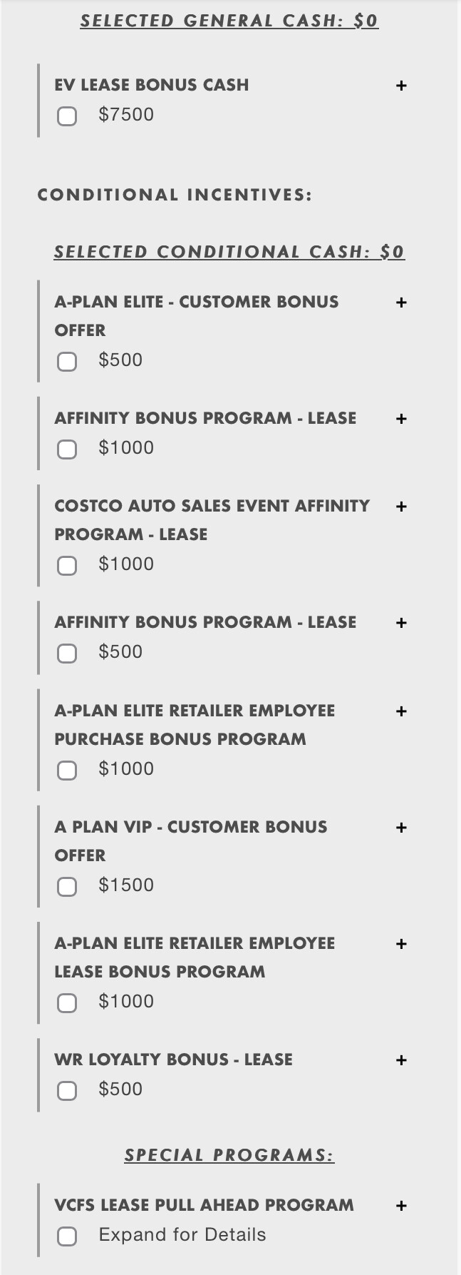

I believe so. Here’s the email I received last week.

No dealer discount doesn’t seem right. Can you pick one up from another market?
Plus I used a random MN zip to check for incentives.
You dont qualify for any of these besides the EV lease cash?
@Benedetto is your guy, if he has any recharges
We qualified for the EV Credit, A-Plan Elite (Healthcare), CostCo ($1000), and the dealership had a Memorial Day $1000 off MSRP. So we had a total of $10,000 in incentives.
