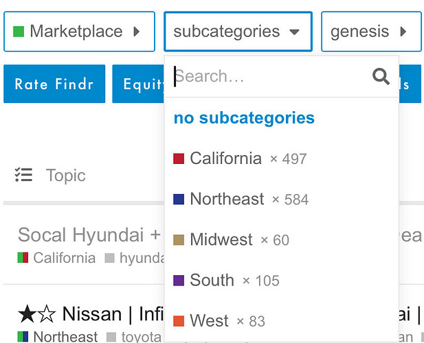

Have you checked Marketplace to see what typical discounts brokers are offering?

There is one Marketplace broker in the NE who is offering GV70 Performances, but they don’t have a price or calculator link. Another broker is only offering another (less expensive) trim, but says that the programs stink this month.
Might be worth reaching out to one of them, just for comparison. Brokers can sometimes take awhile to respond, just as an FYI.

Is there an easy way to find brokers who deal with Genesis. I communicated with one but he only had one car available not in the model or color I would like.

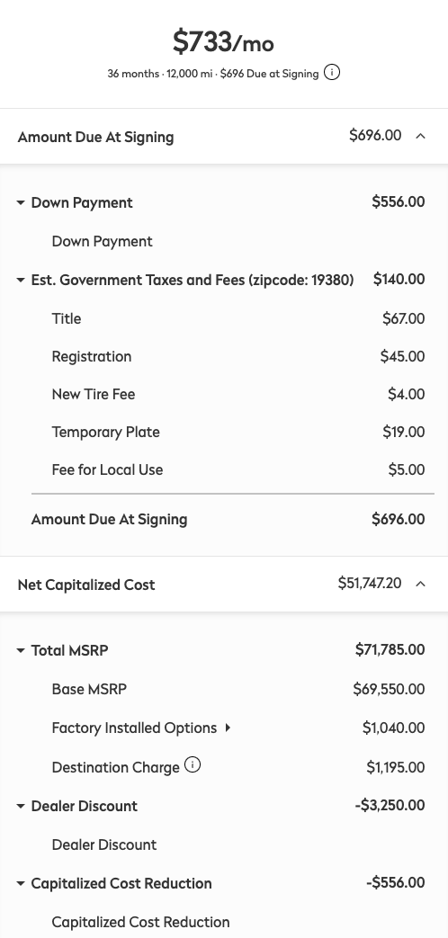

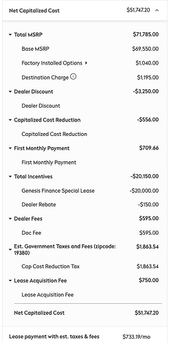

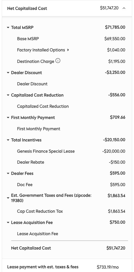

I have a possible deal for a Genesis GV60 that I am trying to match in the calculator. I told them to make the upfront payment minimal and I wanted to use calculator to tune my payment. I think this is a good deal and welcome thoughts if it can be improved.
These is a line that reads “Cap Cost Reduction Tax $1,863.54”, but I am not sure what this is. I will ask tomorrow, but not sure how to account in calculator.

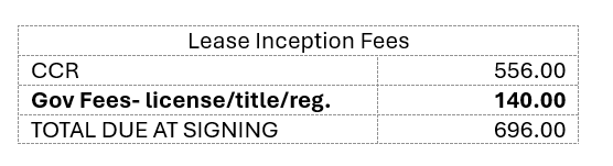

Now, table all lease inception fees and how they are to be paid. Depending upon how the CCR is calculated (there are several different formulas), will determine the amount due at delivery (signing). I always calculate the CCR so that DAS = 0 or DAS = 1st payment plus Gov. fees. As a side note, I would not capitalize non-taxable fees such as taxes and gov. fees. In those states the tax the individual payment streams, you’ll pay tax on capped non-taxable fees. As such, I would pay those at lease inception, if possible.
Bottom line: 696.00 drive-off fees followed by 35 monthly payments of 734.00 each.

The dealer sheet has “Cap Cost Reduction Tax $1,863.54” and I have no idea what that really is or how it is calculated. I will ask.

It’s 556 CCR + 140 gov fees. See the dealer worksheet. The 556 is what they’re asking you to put down… to be used as a CCR. Down payment means cap reduction.
Did you look at my first table posted above? It’s the tax on the total CCR computed using a sales tax rate of 9.00%. This is the rate the dealer used. I don’t know if it’s correct or not. You’ll need to make that determination.
I think you need to look at my first table and decide which capped fees you would like to pay upfront. I would suggest CCR tax, 1st payment, and Doc fee. The CCR tax and payment will need to be re-calculated. A portion of the 20150 will be used to pay lease inception fees and the balance allocated to the CCR. The CCR calculation is quite complex. If interested, PM me.

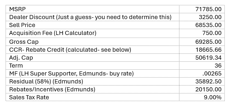

I’ve allocated the 20150.00 rebate to lease inception fees, and the balance to the 18665.66 cap reduction calculated below. And, thanks to @mllcb42, I’ve assumed that PA does not tax rebates/incentives. The revised tabulated data are as follows…
Compute the CCR:
Substituting the above assigned values into the equation, we get CCR = 18665.66. Use the CCR to compute the base payment. All lease inception fees are summarized below.
