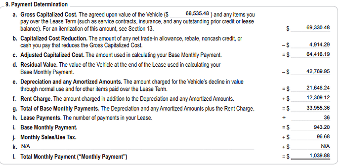

I got an offer for a lease deal on a Lexus RX 450H+ from a dealership. I’m planning on keeping the car for a long time, so I want to buy out the lease immediately. I’m very new to the leasing process and I had two main questions that is preventing me from moving forward.
  1. When I buy out my lease, am I paying the Adjusted Capitalized Cost (9c)?
  2. I’m not sure what 32D means for the difference between the Adjusted Capitalized Costs and app depreciation and other amortized amounts accrued through the date of early termination calculated in accordance with the constant yield method.
Based on my understanding, OTD pricing on this car will be $64,416.19 + tax (10.5%) which would put me at 71,179.88 total OTD. I think there are some other fees associated such as transfer & documentation fees (finance manager quoted $15 + $80) for these two.
I’m confused because this seems like a really great deal. Every other dealership that I called said that I should just take this but I’m not sure if I’m missing any gotchas. Is my understanding correct?
Any help would be great! Thank you in advance!
Yes or very close to it with some minor adjustments for daily interest.
Some banks have a purchase option fee but sounds like yours doesn’t.
As @max_g indicated, it is very close. Your buyout is computed as follows…
Initial balance = Adj. Cap – Base Payment
= 64416.19 – 943.20
= 63472.99
The 7.688596% is the constant yield rate for your lease contract. It can be calculated using the RATE function in Excel. I’ve referenced this, in some detail, in several of my posts in other threads.
Your buyout is…
(Adj. Lease Bal. + any purchase option fee) x (1 + tax rate) + applicable fees
Your sales tax rate is 10.25%. Your buyout is calculated assuming you buy the vehicle within 30 days of lease inception. Remember that payments including lease finance charges are due and collected one month in advance.
