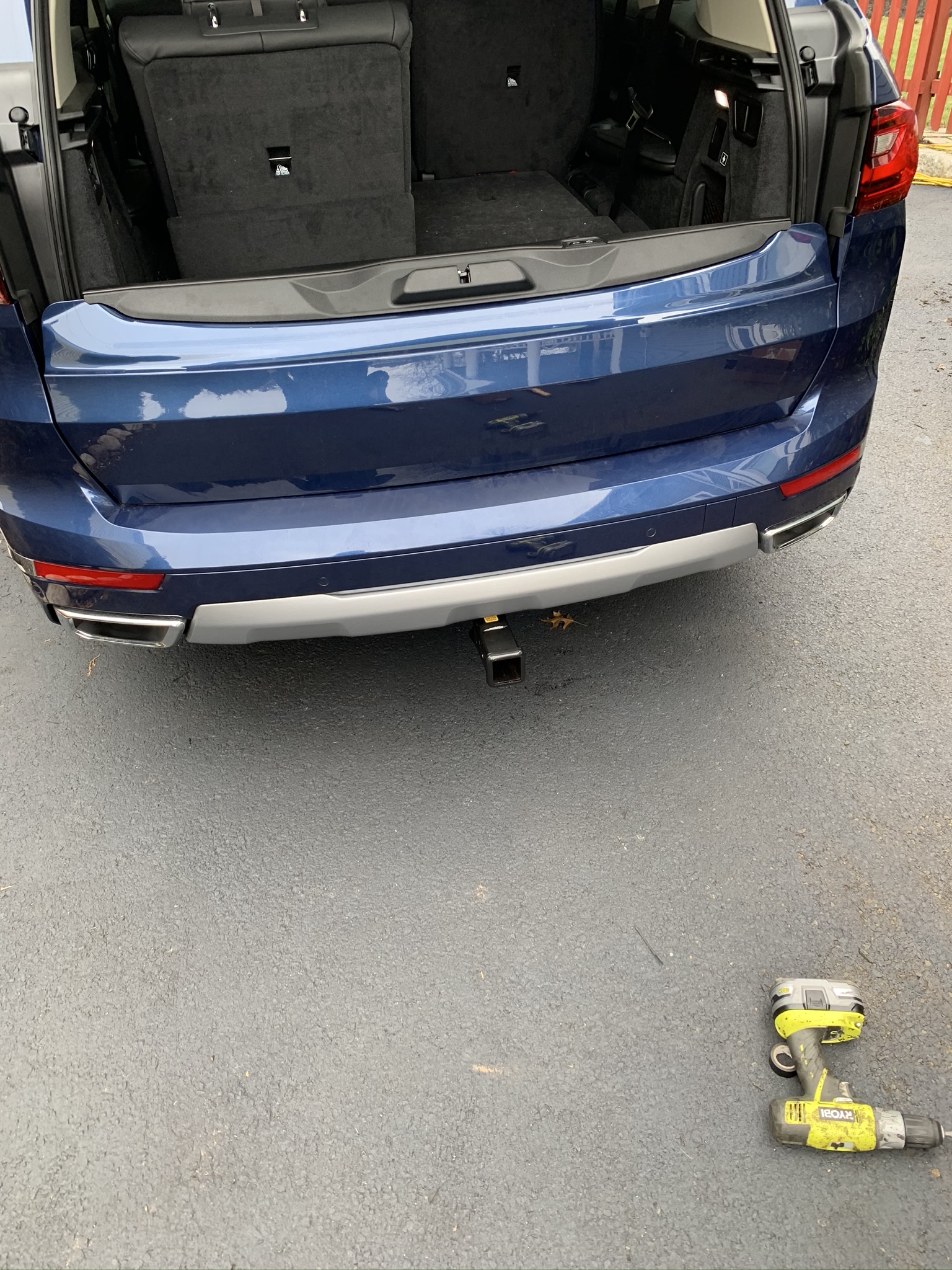

I just installed the stealth hitch on my 2020 X7 since Mike couldn’t find me one with a OEM hitch :smiley:.
It was harder than I expected and a little nerve racking when removing painted trim for example that didn’t easily snap off. Wiring was even more complex as German cars don’t like if you pull power from the tail lights so you are expected to run it from the battery. There was one piece of the under trim that had to be cut that was rather simple with a Dremel tool.
On the positive side, I was impressed with the quality of their product and it works well. I would buy the package with both the box and the hitch as the box is solely for a bike rack, etc with a 600 lb limit. You cannot put a hitch receiver in the box to tow a trailer.
You don’t notice it at all and candidly will debate just leaving it on the car when I turn it in as it’s unlikely it would be flagged on inspection vs. taking a few hours to remove it. Definitely worth the time and money if you can’t get it stock.

You’re braver than I am!
Fancy Ryobi tool. I guess it costs fortune LOL.
:rofl::rofl::rofl:
Yup… had to sell my Dewalt tools to afford the car and the hitch :disappointed:
Good move. LOL
My garage is full of neon green tools. For home use, they’re awesome.
