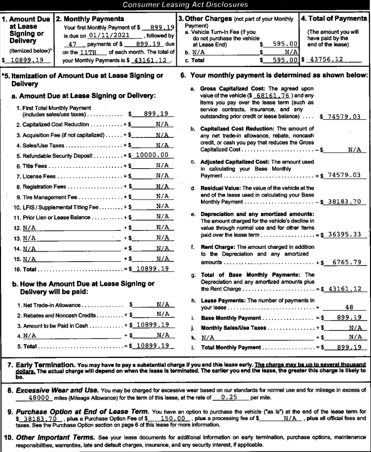

Just looking to confirm what my buyout will be at the end of the lease. Line 9 show a purchase option of 38183. Does that amount include my MSDs or am I paying that amount with them keeping my 10000. This car is leased through MBFS. Thanks.
At lease-end: RV + Disposition fee - MSDs
Roughly?
43161.12 + 38183.70 - (early buyout) + Sales Tax + fees - 10000 - all current payments
EarlyBuyout = (6765.79 / 48) * (48 - TotalMonthsPaid)
Total Months Paid = If started in 1/2022 and it’s 9/2023 then that is 20
CurrentPayments = $899 * 20
No.
The amount you would write a check for or finance would be:
$38,183 RV + $150 purchase option fee - $10,000 MSD + Tax most likely on the $38k + reg/title.
