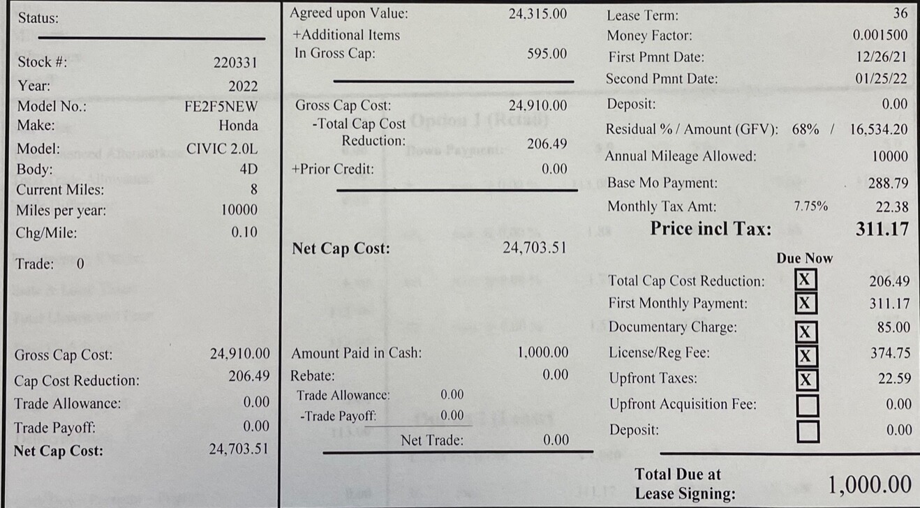

They don’t have it broken out. All I was given was “Vehicle Price”. In another deal I got late last year, they had the destination fee broken out on the sales sheet. It was “Agreed upon value (MSRP) +Additional Items in Gross Cap (Destination)”. I attached the deal I got in 2021 which was my guide in creating my current model.
I recreated the same numbers in the excel model I have attached. That could be something I’m missing
The additional items in the gross cap before was the acquisition fee, not destination.
If we assume that $3500 down is actually $3500 das, i get $367/mo
Ahhh you’re right!! Don’t think that’ll change the numbers though, just labeling optics.
Interesting, thats a little closer to their number monthly payment . Guess i’m factoring in the accessories incorrectly on my calculator.
I must be messing up the adj cap cost value because the deprecation base cost in the calculator you provided is higher than mine
