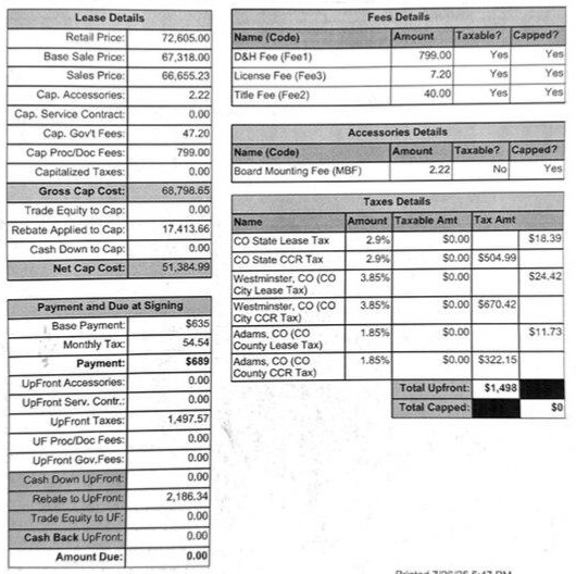

Hey all, just curious if anyone has recent info or feedback on a Jeep Wrangler Rubicon X 4xe lease pricing. this quote is from the Denver metro area.
24/12, Zero down, MF .00130 (base rate, not marked up), 55% residual
MSRP $72,605
Amount off MSRP $5949.77 (just over 8% off)
Incentives
CO tax rebate - $4100
SFS hybrid - $7500
Lease cash - $8000
Total discount $25,549.77
I went in with 15% off MSRP target, got just over half way there. My plan is to keep trying until the last day of the month. I’m communicating with 6 dealers, this deal is the lowest so far.
I must be missing something with calculator, numbers not lining up for me. In CO there’s a tax rebate of $4100, but I’m not clear where to input into the calculator, so I used the taxed incentives area.
Can you post your calculator and incentive breakdow ?
Just edited the post, sorry for not including that. Numbers not aligning with lease offer, so I must have inputted wrong or dealer hiding fees/etc.

I updated the calculator link with the acquisition 995 fee, still $82 bucks off their offer sheet.
the small fees $7.20 license, $40 title, and $2.22 board mounting fee. I didn’t put these in the calculator, assuming I should have. where would I enter these types of fees in the calculator?

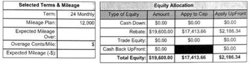

Dealer provided the full proposal. Was told by dealer the taxes for the rebate/incentives had to be collected up front and no way around it. Did some googling and it sounds legit/accurate, but would love to hear from all you lease experts.

Yes, I understand that CO tax (at your sales tax rate) is due on rebates/incentives at time of sale or I guess you could roll into the payments but why pay tax on tax.
$3500 tax credit + $600 assignment bonus, total is applied as cap reduction
It’s $4100, however some dealer at 250 processing fee, some dealers pass on full benefits to customer.
Agree, in Colorado, taxes are collected on rebates/incentives upfront.
