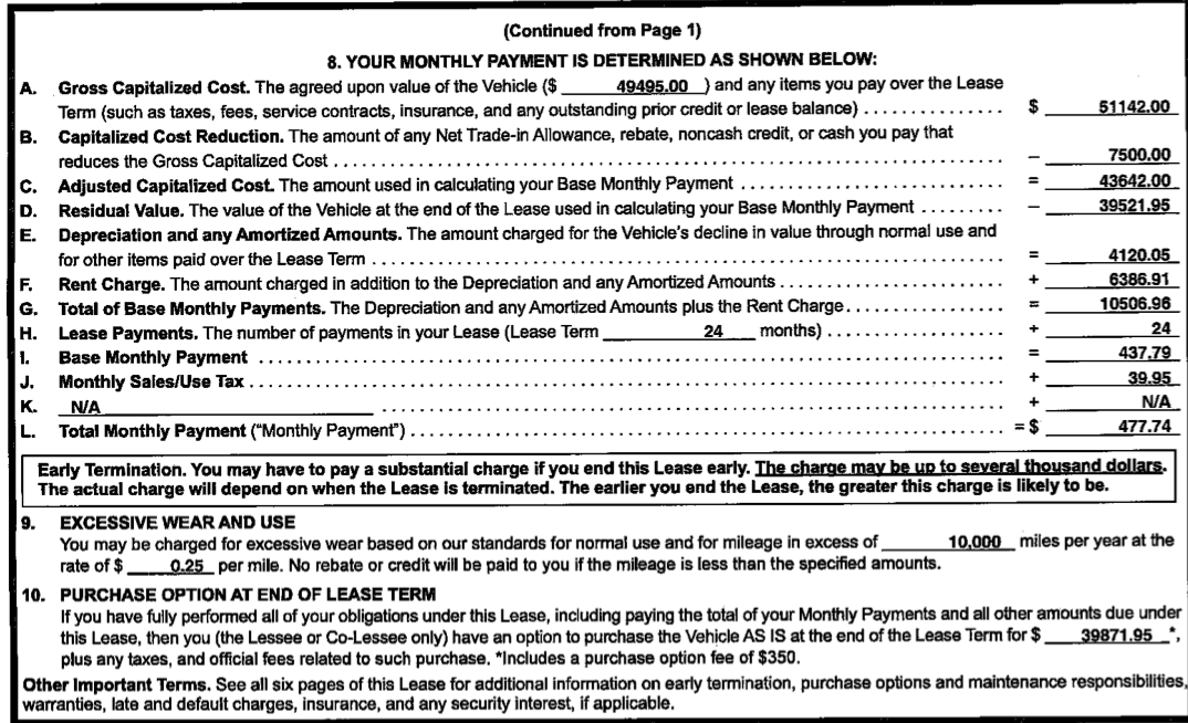

Hello Leasehackr experts! Requiring some info on this IONIQ5 SEL AWD lease in SF Bay area in California. This lease is not through HMF but is from USBank. MSRP was 52495 and I could only negotiate 3k off MSRP to make it 49495. Added about 952$ worth of some protections that made the gross capitalized cost 51142 (49495+952+695 acquisition fee). Did not put any downpayment - only had to pay taxes on the 7500 rebate, licence, doc fee and 1st month payment

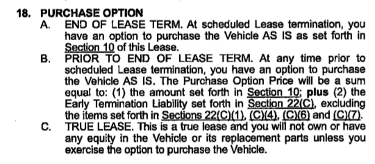

Looking at the Early Buyout option - I do not see any mention of adding the 7500 to the Residual value in my contract. Is my understanding correct that my immediate buyout price would be the Adjusted Capitalized cost (and not the adjusted capitalized cost plus 7500) ? Below are the numbers
MSRP : 52495
Agreed value : 49495
Gross Capitalized cost. : 51142.00. (Agreed value + aquisition fee + some add ons)
Cap cost reduction : 7500
Adjusted capitalized cost. : 43642
Residual value : 39521.95
Depreciation and any amortized amounts : 4210.05
Rent charge : 6386.91
Number of payments : 24
Base monthly payment : 437.79
Monthly Tax : 39.95
Total monthly : 477.74
Purchase option at lease end : 39871.95 (Residual value of 39521.95 + 350 purchase fee)
Lease contract says “Purchase option price” at any time prior to end of lease term would be : 39871.95 plus the “lease balance”
Lease balance is calculated as -
(a) Base monthly payment times the number of monthly payments not yet due minus
(b) Unearned rent charges included in the base monthly payment not yet due
Any help here is very much appreciated! Thank you!!

Those US Bank buyout rules… yikes. Definitely not as friendly as HMF.
HMF uses the adjusted cap cost as the buyout price then subtracts a few things. It’s simple to understand.
US Bank starts with the RV value then adds 22 (C) (2,3,5) - 22 (C) (5) is the lease balance which is [monthly payment x remaining payments] minus [Unearned rent charges included in the … ]
So I think that’s $39521 + ($10506 - $6386) → $43K ish and assuming you paid the next day (if possible - which it is not).

I’m pretty sure USBank added $7500 to the residual.
It looks like their base residual is actually 61% and then they add $7500 to it to come up with that ~75% residual (based on your $52,495 MSRP).
While this ends up reducing the payment (higher residual, lower monthly) this is not as good for an early buyout because it’s inflated.
I’d just go through the 24mo lease because in 2 years who knows what the Ioniq 5 is worth and there will be many more EVs to choose from.
If you’re saying they added it to the residual - it is also applied as a capital cost reduction too that brought down the adjusted capitalized cost. So if I were to buyout immediately - you say they will add the 7500 to the residual value?
