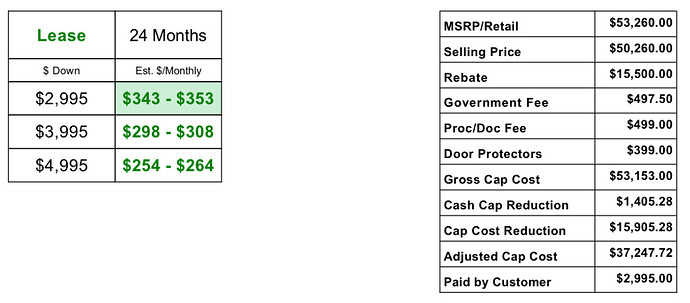

Can I get help looking at this deal for an Ioniq 5 SEL AWD? The MF is supposed to be .00115 RV 58% on a 24mo.
Something seems off to me in the calculation, but this has been my closest deal with something decent, located in IL.

Can you post a calculator to help clarify what you think might be off?
What is your tax rate where you are? I used 7.75% and came up with a payment of $285 after taxes for 24/12K.

Thanks y’all. Ended up moving forward with another offer. Located in IL.
Net effective $404/mo $0 down. Shared here.
Dealer seems to be willing to replicate if anyone in IL is looking for a similar offer.
congrats for your new car!
How is the effective $404 is calculated?
389 + 740/24 = 419.8
Thank you! $740 includes first payment
