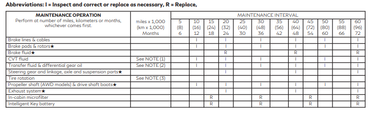

Any other QX60 lessees see the cars maintenance schedule? The car needs a full synthetic oil change every 5,000 miles? That seems extremely short given that most synthetic oils are rated 10K miles and up?

Synthetic Oil Change (Every)5,000 miles 39/m lease $150x7=1,050
Tire Rotation (Every)5,000 miles $50x7= 350
Cabin air filter (Replace) (Every)15,000 miles $150x2=300
Coolant (Flush/replace) (Every)75,000 miles
Air filter (Replace) (Every)30,000 miles $150x1=150
Brake fluid (Change) (Every)20,000 miles $200x1=200
Spark plugs (Replace) (Every)105,000 miles
About $2,000 maintenance cost for 39 month/12K lease term?

brake fluid…yeah I know but, Infiniti maintenance book says that.
9-10 (Maintenance and schedules)
