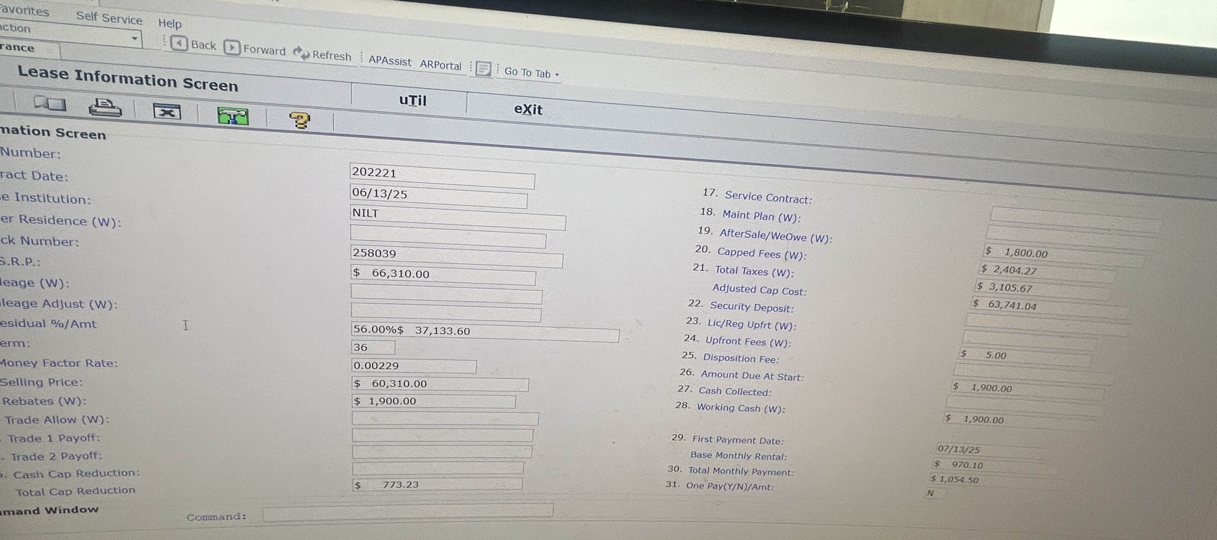

Hello, I’ve been running numbers on an Infiniti qx60 sensory, and was quite happy with numbers I was running. MSRP $66,310, I was quoted a price of $59310, and that’s before lease incentive of $950. After running current numbers w/ 0.00178 MF and 56% residual for 3yr/15,000 mile, I was coming to number of about $910 / month total with local tax rate of 9.1% and expected fees.
The quote they sent, first off, had a high MF rate. I already called them out on that on got a story about I would need great credit score for MF I mentioned (I do, so will be changed), but even with that changed it’s still higher. What I didn’t get is a couple other numbers, including after sale/WeOwe and amount due at start (wanting $0 down, so just expecting first month payment upfront). Can anyone provide some insight as to what I’m dealing with here. Thanks much!
The dealer worksheet is pure garbage. Lots of stuff missing. You may want to read this…

They have $60,310 as the selling price and used a tax rate of 8.7%. Whatever that $1,800 “WeOwe” is was also added to the cap cost. But they show $1,900 as rebate to offset the $1,900 DAS presumably for $0 cash up front from you. Are your fees really $2,404?
That said, correcting the sale price, lease incentive, money factor and taking out the $1,800, and adding 10 MSDs still gets a payment about $805 and there are many other cars I’d rather have at that price.
So better to get a better price and learn how to structure a lease…

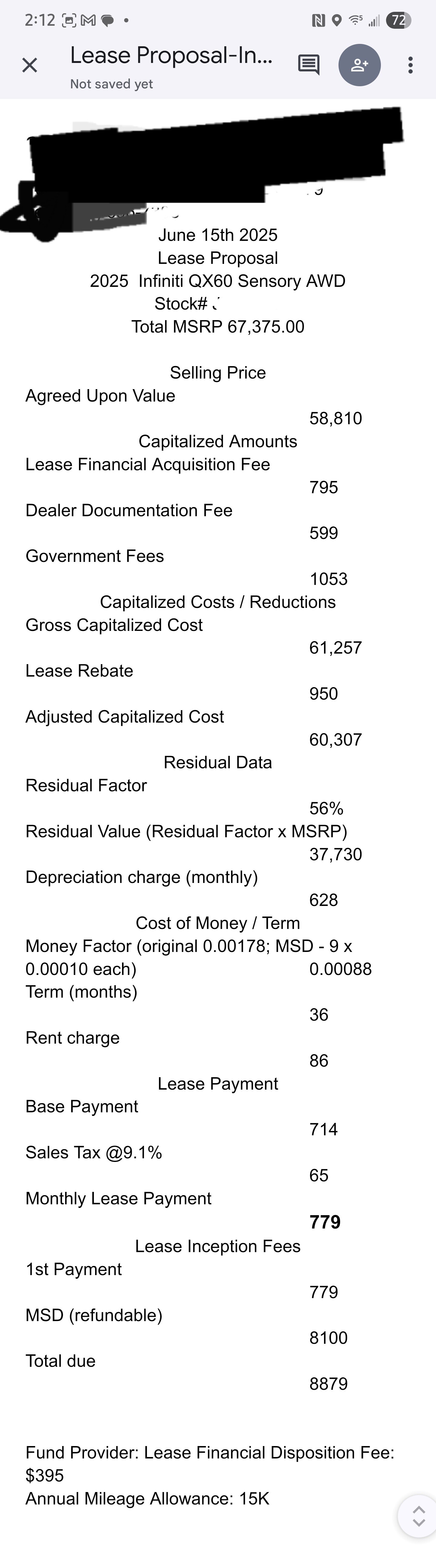

Since I wasn’t happy with the dealers quote I posted, I took your advice of presenting a lease offer to another dealership that said they’d beat the other dealers offer. If it helps anyone, this is what I made. I’m happy with this, so we’ll see what they have to say. Oh, and I ran the numbers with the flex lease, and it appears to save about $10 a month w/ 10k and purchasing the extra miles. Not sure i feel like trying to figure out the ins-and-outs of that program at this point, even though it may be pretty straight forward.
