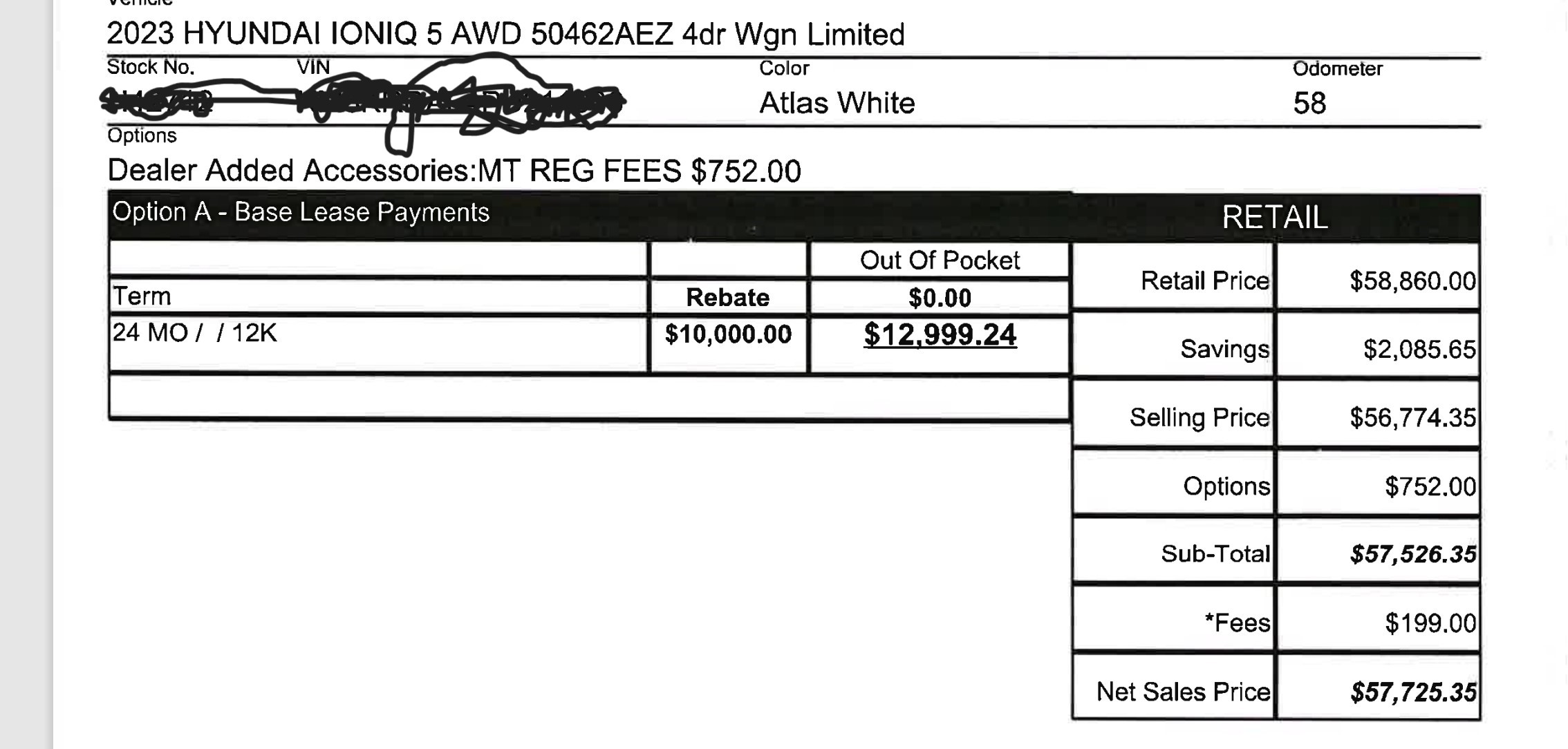

Finally got the deal done without having a stroke. What a pain in the arse. MSRP was $58,860. One pay lease out the door of $13,699.80 About 1k more than I thought it should be but still much better than buying outright. Two hours after I accepted the deal a different dealer called back and offered $12,700 which was 2k lower than what they said their bottom dollar was. Oh well it’s over and we really didn’t want a black one plus it had the front bumper drilled for the plate which we don’t need. So picking up our White on Black AWD Limited tomorrow.

We got the 2,500 loyalty and the 7,500 lease incentive. Signed the one pay last Saturday. It took the dealer a week to figure it out. Our loyalty vehicle was our '23 I5 Limited AWD that was totaled. Replacement '23 I5 Limited AWD. Wrote one check for $12,999.24 and done. Montana registration and title included. Loyalty vehicle was also registered in Montana.

After they couldn’t figure out the lease our dealer took off another $700 from the one pay to keep us from buying at a different dealer. If the owner of the dealership hadn’t gotten involved the deal wouldn’t have happened. He let us take the car with a dealer tag with no money paid. Took them 7 days to figure it out.

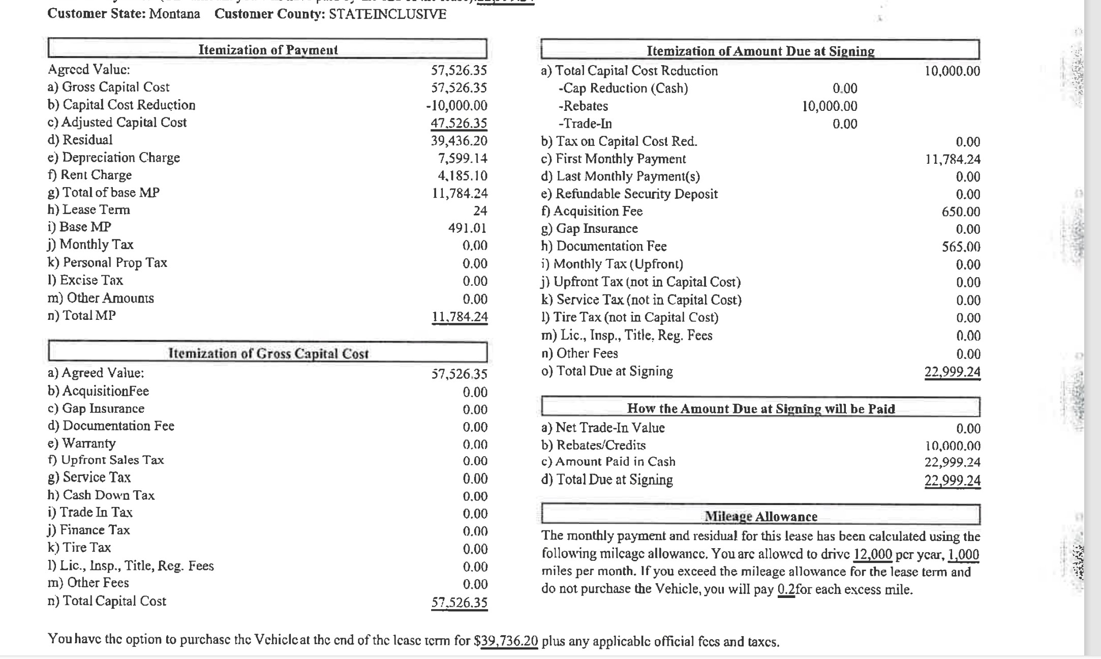

How is the residucal value of 39,436.20 calculated? I thought it should be 72% for a 24months lease on 57,526.35 which comes to 41,418. What am I missing?
Residual is based on msrp, not agreed value
