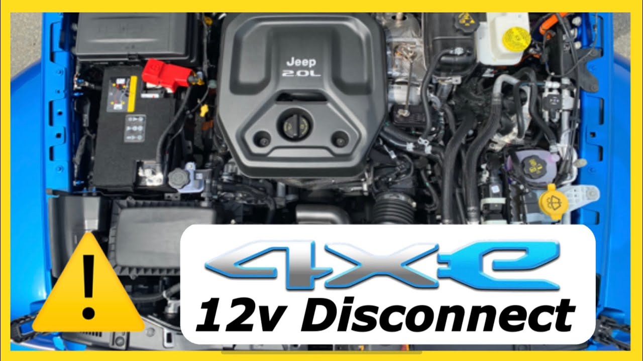

Dyslexic today…IDCM…in preparation for my long journey, I reviewed Brandon’s vid about what fuse to pull if you want to manually charge/boost/jump the LVB (Fuse 109-IDCM?), and his vid suggests plugging in a charger will charge the LVB and HVB at the same time. I have one of those small Li-Ion battery jumpers in my road kit, and I wanted to be prepared for this scenario.

Here’s Brandon’s LVB discconnect from HVB fuse vid:
