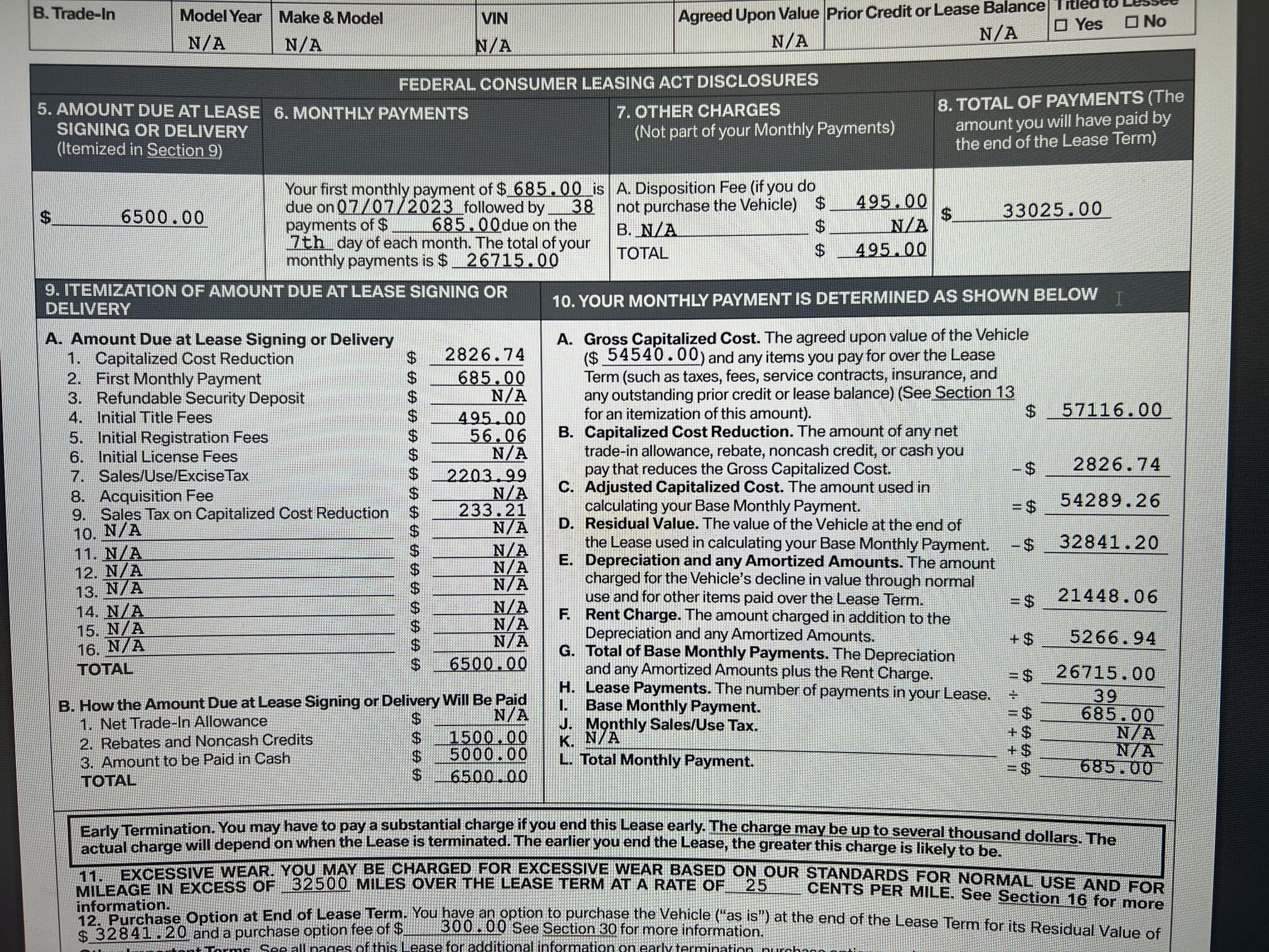

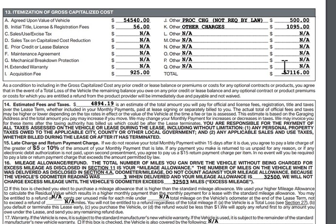

Show section 13 of contract
LMAO…er, laziness…
That’s where you’re wrong. I actually did try and wasn’t able to get the number, only reason I’m looking for assistance.
Then post your effort…
Sure thing
OMG, try again that was pitiful.
Search deals on this site for your area and use a broker otherwise you are gonna be hosed.
Redid link
Did you sign this deal already?
Yeah, 1595 of who knows what in there on the cap…and I have no clue how NY lease taxation works! :slight_smile:

First thing to do is ask what J and K are for…maybe doc fee and profit adder?
Yep, MF=((RC/(ACC+RV))/39 is 0.00155, almost like near full MSD were accidentally taken off 0.0019
If deal is actually rejected by BMWFS, will dealer be obligated to even take the vehicle back or make me sign a new contract with the correct MF
deal calc.
No. It’s 0.0019 for a 2023 and 0.0019 for a 2024.
