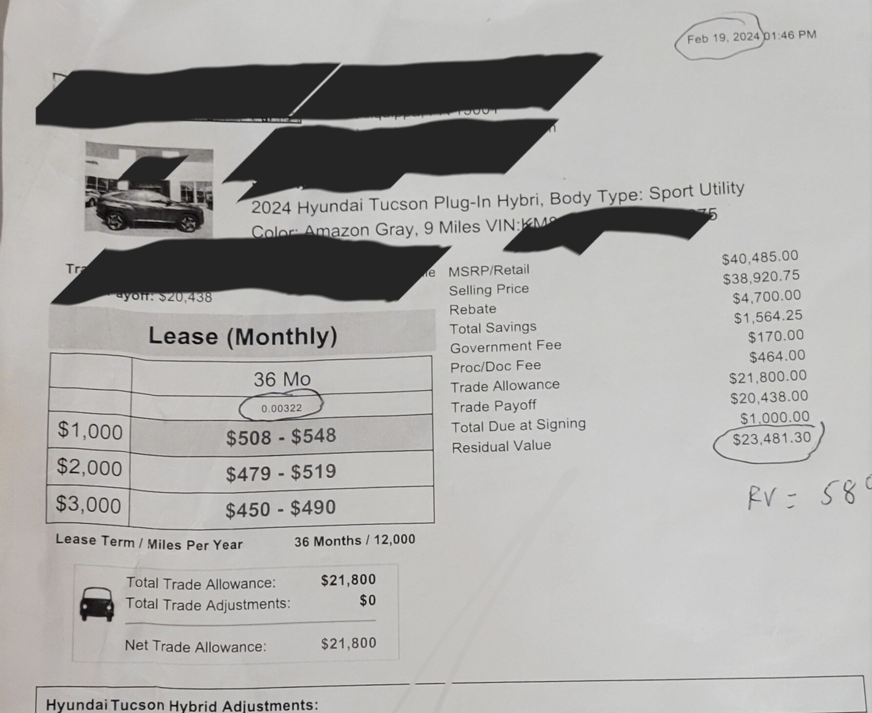

This was mid February on a lease for 15205
I was expecting .00237 and 66% residual
You can see how at those numbers an extra 500-1000 off msrp doesn’t really help against what I was expecting

That’s what I did. With my trade I was expecting $430-450. What I got was anywhere from $515-$650 at multiple dealers
I was asked to show proof. That happened in February. I have many more examples from Feb-Last week. Do you want to see them all?
I got the numbers from edmunds lease forums. I confirmed it with another dealer further away.
That much discrepancy sounds like you had the rv/mf of the gas version vs the hybrid, but it may have been a different bank. If youre seeing that kind of difference, that may be why. Sometimes its a case of them using a different program with a larger rebate, etc.

Having a current example where one could actually compare against the current programs to see what they should be would be helpful. Theres teally no easy way for us to do a post-mortem on last month’s programs.
It was the exact same make, model and trim. I double checked.

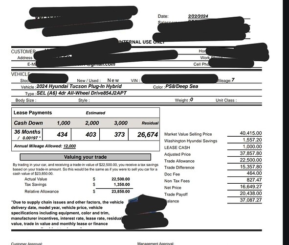

Here you go. Same make, model, trim, 3 days apart.
Neither of those are current, so we cant verify what they should be, but notice the significant increase in incentives that accompanied the change in rv and mf? Thats either a mid month program change, in which case you need to look at the whole thing or a different bank.

I don’t have a current one because the programs have just changed. Although I did try to get a deal today at Kia where they offered me 61% RV on a car and then offered me 62% to lower the payment. But they took the sheets.
But why do you need to verify it to believe me? I’m showing you the proof and asking for advice but you’re just stuck on the one part about RV changing. It doesn’t matter if they can adjust RV or if they can choose different banks/programs. How do I get them to agree to what I’m expecting based on the research I’ve done when we are $100-$200/mth apart?
