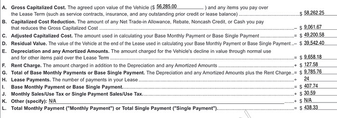

Im leasing a KIA EV9 and im confused about the application of the 9500 rebate. Do these numbers look correct. Should part of that rebate be allocated to the 1st month?
It also appears the taxes are in there twice. Is one of those the taxes on the rebate?
MSRP was 61785
Negotiated Price was 56285
RV 64%
MF .00006
Im in Florida and the Dealer is in Louisiana
I assume that the $9061.67 in line B of the first section is part of the rebate and that the remainder of the rebate is showing up as amount to be paid in cash under the due at signing section?
It is. Is that the correct way to do it?

9500 in rebates (7500 ev + 1500 summer bonus + military? Or a vin specific rebate), using 9100 of that as ‘downpayment’/ capitalized cost reduction, then the rest to cover that payment.
Guessing this is a sign and drive deal? Or have I had one too many this evening.
That is the way I read it but they stated the 1st month would be due at signing in addition.
Can you please post a redacted offer sheet for us, as well as confirming trim? Florida taxes rebates iirc. Or post more of your contract (basically everything sans vin is helpful)

I did evaluate your lease and performed all the calculations, including the calculation of the CCR, and can confirm that everything was done correctly. Florida levies sales tax on the Indvidual base payment streams. What I don’t like is that the base payments include capitalized sales tax of 712.50 = 7.50% x 9500 as well as the tilt/reg/license fees (see itemization of gross cap). These items are non-taxable IF you pay them upfront. Since tax is levied on the base payment, you are paying tax on tax.
There are several ways to construct a lease. Never allow the dealer to control the deal. Next time, you may want to create a one-page lease proposal like the one below and email it the dealer and negotiate via email/phone…
Notice that the rebate was used to cover all lease inception including the CCR. In your lease, a portion of your 9500 rebate was used to pay your 1st payment of 438.33. The balance was used as a cap reduction (CCR).

I’m missing 438 bucks in my math. It could be the baileys talking though. Dealer capping first payment and collecting it anyways maybe?

That was what I was missing too!
The dealership also said 1st Month would be due at signing. That doesn’t make sense to me. I was under the impression I would pay the first month and the 9500 would go to cap reduction.
I would double double check in the morning. Sometimes salesppl misspeak, they don’t always or need to know how leasing works or always do deals a certain way and never do sign and drives. However it may be, verify and report back!
It was the finance guy and he said “it’s how Kia does their lease” after I stated multiple times that the contract didn’t show that.
