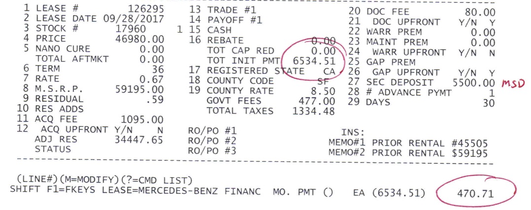

I got a couple of quotes from 2 dealers in the Bay Area. They are both P1 package for 36 months 12k miles lease.
First quote:
I’m not sure if $470 is before or after tax+interest, also no indication of how many MSD and MF. I need to clarify.
Second quote:

First thing is the mf should be .00037 so they have that marked up. The residual is right. Ideally you get the price down some from where it is.
Is this from Mercedes of San Francisco? Those people there suck. They lied to me and someone else I know numerous times.
Thanks, the top quote is from MBSF. It wasn’t very clear. What did they lie to you and your friends?
So if I max out 10 MSD, MF should be .00037 at any dealer?
What else can I ask them to reduce?
Thanks
Only other thing besides the mf is asking them to reduce the sale price and reduce the acquisition from $1095 to $795. Dealers find it hard to relinquish the rights from Mercedes that allows them to mark up the aquisition from $795 to $1095.
