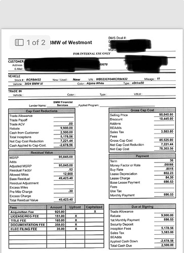

fwiw: i am leasing a 93.6k msrp i5 m60 (53 miles) for 897/month, 2.4k DAS. 36/10
your location and taxes would be extremely relevant if you’d like to share a payment for comparison
The way I see it, DAS is going to be close to $3000 regardless the deal with Chicago/Cook county tax up front on the credits and lic/plat/doc fees what they are.
Not sure about this, sorry. I would guess that the demo miles will not be accounted for in the residual value, you should be safe with the RV you get off here.

I’ve learned a lot here. Moving towards iX. I feel like I’m close here but can’t find where the extra $60 or so monthly is based on the calculator. Any advice?
Your money factor is not set to what they’re using, which is .00066.
In IL, taxes are taxed when rolled in, similar to New York, so if you fix the money factor and apply the NY tax rules, you get an exact match:
Thank you. I assumed they were giving me the standard Subvented MF offer. I assume then that’s where they’re making their extra and where I could try to negotiate if I wanted to go lower?
