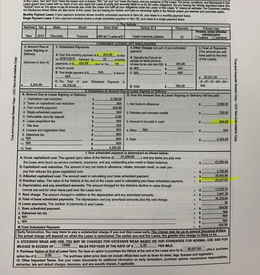

Got them down to 455 a month 12k miles. Seems pretty good to me
Don’t rush this. This is $455/month with $3,000 down, right? How much of that is cap. cost reduction? I.e. how much of that $3,000 is towards 1st month, doc fee, and title/registration?

Heres the complete breakdown?
This is the contract…ask for the lease worksheet.
Have you switched to a different vehicle or different terms (months/miles)? I ask because the residual highlighted yellow in 7d, $26,927.60 is 59% of the MSRP of the vehicle you posted initially - $45,640, and the residual on that sheet was 57%. So it looks like you switched from 39 months / 10k/year to 36 month / 12k/year.

  1. Common wisdom on this forum is never to put any cash down on a vehicle lease, as you’re doing in 6.B.1 of the contract - $3,000. The reason being if your vehicle is totaled, insurance will not make you whole with that $3,000 - it’s lost. I would ask them to cut you a check for $6,000 instead of $3,000.
  2. That $3,000 down, called capitalized cost reduction, is decreasing your actual monthly payment. Your true monthly payment isn’t $454.89 it $3,000/36 = $83.33 + $454.89 = $538.22.
  3. Your first sheet has Ancillary/Other of $1,619…what is this? Ask them for a breakdown.
  4. You need to find out what the base Money Factor is, so you can see if they’re marking it up. If you’ve already done that, let us know that.
  5. Have you contacted other dealers to see how they compare?
  6. Try to plug this info into the calculator…here’s my attempt, which doesn’t match your payment…something is clearly off, but you want to get to a situation where you understand the payment. To do this, you need to know the MSRP, Sale Price, Lease Cash / Rebates / Incentives, Months/Miles, Residual, Money Factor, and how Taxes are calculated in your state.
