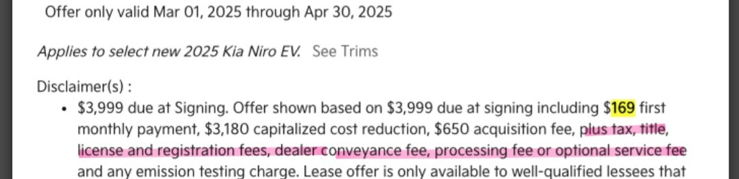

The salesperson at kia dealership verbally noted that they have a special going on this March for Kia Niro EV 2025 Wind, lease for 24 months, 10K miles allowance for $169 monthly. 0$ down-payment
Is this a good deal?
There’s absolutely no way to determine that based on that information. Is there any down payment? Tax, tags and fees due at signing? Manufacturer and dealership lease “specials” are usually anything but.
It’s highly unlikely it’s a good deal if it’s what the salesman openly offered.
0 down-payment.
I didn’t ask about taxes, fees… Etc
You should always ask about this. They can add up to thousands of $
zero down on a lease is not “sign and drive” as most people would assume. Sign and drive is just signing for the lease and driving away, zero due at signing. Zero down = Paying upfront taxes, dmv costs, acquisition fee, doc fees, title fees, 1st payment etc. This can easily be 2-6k depending on where you are buying and what the fees/taxes cost.
It can be more complicated than that. Zero down is just zero additional cap cost reduction. You can have a zero down lease where you pay thousands in upfront taxes and fees. You can also have a zero down lease where the taxes and fees are capitalized.
They’re all “zero down”, but the actual out of pocket amount can vary by thousands. It’s a totally ambiguous term that dealers like to not be transparent.
Yes, this is very true, a dealer can use this term to mean almost anything they want. My point was to warn the OP that the real question they need to ask is “how much due at signing” when they are told “zero down”. I would wager the average salesperson doesn’t even know the difference between 0DAS and “0 Down”.

Yes if you get a deal 169/month all in its a good deal.
I’d put my mortgage on this not actually being the deal all in.
This is probably the deal. $0 down but really $4K down, errr I mean due at signing.
Plus plus plus
But good news!! No security deposit required. :laughing:
