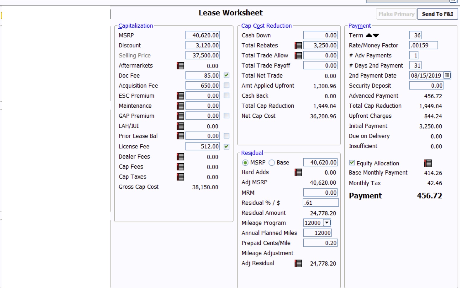

Hi Everyone,
New to the forum and would appreciate your feedback on the below lease being offered for a 2019 Chevy Traverse LT Leather with 3LT in CA.
MSRP = $40,620
Discount = $3,120
Sell Price = $37,500
Items Added to Sell Price:
Acq Fee=$650
Gross Cap Cost = $38,150
Cap Reduction = $1,949
Net Cap Cost = $36,200
Residual = 61%*$40,620 = $24,778
Money Factor = .00059
Base Payment = $414.26
Tax (10.25%) = $42.46
Total Monthly Payment = $456.72
Up Front Fees:
DMV = $512
Doc Fee=$85
1st Payment = $456.72
Total Excluding Tax = $1053.72
Rebate Credit = $1,300.96
I’ve been working with around 5 dealerships and this is the best deal I’ve received so far. I know it’s not an amazing deal, but given that there aren’t enticing GM lease deals this month, my impression is that this is respectable. The lease calculator score comes to ~8.
