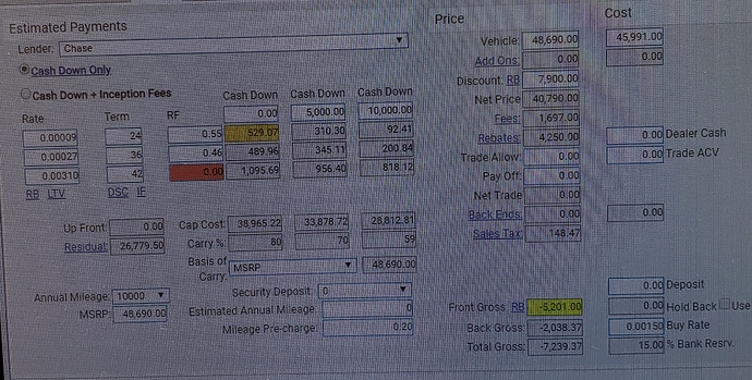

Here is the lease sheet.
No idea how he got 4250 rebates, I only heard of 3250 so far.
I did not know how to get the numbers in the results he got, so I played with the reg fee and the acq fee. I do not know how to make it right. Below is what I got:
He also said the Ally numbers are the same. I also got the Ally version of the lease sheet but I do not understand it at all, it is perhaps only correct for the 24 months, because the 36 month payment is not the same he gave me in the offer. He kept talking about the “bank fee” for Chrysler which is eliminated in the Ally version (wtf is the bank fee?). Lease calculation just works differently somehow with Ally.
Can anyone explain what is up with Ally and why it does not work? What the heck one MSD is doing there? And is there any way to improve it?
It is $490 if you add another $45 to your DMV fees. They have 1697 total fees and you’ve only put in a total of 1653. The extra $1k is likely the aged inventory cash to dealer.
Anyway, I think it is a good deal based on current numbers.
What is up with the Ally sheet? The MF is much lower with them yet the payment is the same once you factor in the $550 due at signing listed on that sheet. Yet I do get $475 with $0 DAS. So why is that $550 listed there? Unless that is buying down the rate somehow? I didn’t know Ally does that.
Ally doesn’t have a disposal fee at the end, which is likely what he is referring to.
