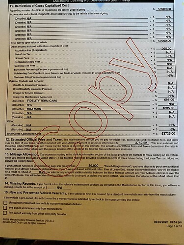

I signed to lease a 2022 glc300 at a Mercedes dealer today. Towards the end of doing the necessary paperwork with the MB finance guy- he says that he’s going to give me a brake pads warranty for free.
I agreed to a pre-paid service A and B plan at $595 and I paid the $1095 acquisition fee upfront. He had me sign a warranty agreement for brake pads with cost of $695 which he said the Mercedes dealer is “covering” for me.
I’m looking at the breakdown on the lease contract:
6a. Gross capitalized cost is $53725
($1095 acquisition fee + $695 brake pads warranty + $1035 for prepaid service a and b)
MB finance guy says I’m being charged $595 for prepaid services and no charge for brake pads warranty.
See attachment- is this guy telling me the truth or am I being tricked here?
There’s another page that has the itemization of the gross cap cost

Sounds like what he did was included the brake pad warranty on the contract, but paid for it himself. The difference here is pretty much exactly the $695 brake pad warranty plus tax
The $750 rebate covers the difference from $11360. The $695 brake warranty was added to the gross cap, which means the OP is paying for it.
Oh, you’re right. I didn’t verify with the contract what the numbers were when asking if the actual das matched the contract das. The contract das is $10610.
I think that I figured it out, I am paying for the “free” brake pad warranty.
I went back to him and asked the finance guy to remove the warranty.
His revised contract does not change my monthly payment because he INCREASED the money factor! SHADY Mercedes finance guy!!
