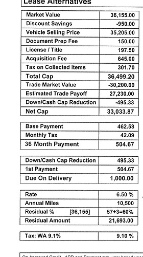

Hi! I am working on a lease for 2022 for maverick lariat lux awd. I live in Eastern WA 99216 and I know the tier 0 is 5.5 for 36 months. Does this breakdown look correct? Even at 5.5 it seems high. I have 3000k trade value and putting 1k down.

When you filled out the lh calculator, did the output match?
No. Calc said 468. Little low since I’ll pay tax on down payment. I did 4800k drive off calculator with .0027 factor. 6.5. 4k drive off is 492
Can you post your calculator?
I did it for 4k drive off which is what I told them which includes 3k trade in. I’m sure I’m doing it wrong🤔
You’ve got the rv set to 61% rather than 60%
If you correct that and match the $3970 DAS amount from the offer, it’s spot on
Got it! Thanks a bunch. Leasing numbers are a pain sometimes
