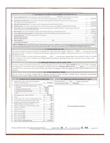

Last year, I leased a new 2023 Hyundai Ioniq 5 SE in the SF Bay Area. Tl;dr, I went with the original intent to trade in and finance, but, likely did everything wrong when I opted for a lease. I’d like some help analyzing my lease agreement and am ready for some serious education on my mistakes :man_bowing:
Initially, I was pretty happy with myself not having to pay much more in monthly payments than I was with my vehicle I used to trade in. I thought I did my best in turning stuff down but was not able to sign the lease without purchasing some things:
  1. Lojack (to which they said insurance [Wawanesa] would give me a discount on my premium but they didn’t) - $1595
  2. Key protection - $349
  3. Wear and tear - $995
It wasn’t until I got home and researched after the fact that my buyers remorse and the feeling of getting taken advantage of was starting to really kick in. I’m pretty sure I did not get a good deal.
A year later, I’m starting to wonder what my options are. My rapid accumulation of miles has really got me looking around for help/options. I know that at the end of my lease, whenever that is, I’d like to properly lease again following all the great advice here.
I was hoping the Hackrs here might be gracious enough to go over my Lease Agreement, educate me on what I did wrong, and help me make an informed decision to move forward. Thanks in advance!!
Edit: removed .pdf upload of lease agreement, added it in .jpg form

Lease matures March 2026. The lease is for 30k/36mo and have used 18,900 so far :sob: I grossly underestimated my use of the vehicle.
At this rate you will be 12,500 over the contract. How much is the overage fee per mile?
You can buy a beater car to use couple of days a week. Lease a second car to split the mileage. Or check your car’s current value if you can sell it for the buyout and wash your hands.
Plan was to use a second car to cut down the miles or wash my hands like you’d mentioned— potentially a combination of both. Overage fee is $0.20/mi
It’s not too bad. $2,500 which is $70 a month.

You weren’t taken for a ride, you were taken to the back seat and given a RAW deal.
Can these still be canceled for a refund (prorated or otherwise)?

I haven’t looked into it, actually. I read about the whole cooling-off period a little too late and I couldn’t make any changes— was too happy with the car to care at the time :face_exhaling:
FWIW, I was able to get my salesperson to give me free OEM all weather mats and a retractable cargo cover a few weeks after all was said and done. Those two worth at least $500+
I should have been more direct. :slight_smile:
Go check your paperwork / call the company that’s providing the coverage and find out if you can recoup some or all of what you paid for these.
If it’s possible anywhere in the USA this far into the lease, it would be California.
Sorry, thanks for clearing that up for me! I will try calling to recoup some of those costs. I appreciate the advice!
