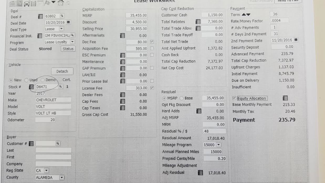

Here’s the sheet I worked with. Just signed iffy since I’m going in this purely on this forum. Thanks guys!
Thats the right deal. You paid a little upfront and brought down the payment. Basically the difference in cost of the leather & comfort package after it gets residualized.

So the difference is the upfront charge and due on delivery ? 1150-1137? So I paid like… $13 down first months payment acquisition fee and licensing. Isn’t that technically 0down plus I get the 1500 rebate?
So your overall, $0 down equivalent payment is about $267. When taking into consideration you are doing a 15k mile lease (about $33 more per month than a 10k mile lease we often see quoted), and you are getting nothing but a $500 loyalty incentive, and it’s a $35.5k unit (not barebones 34k model), that 's a really awesome deal! May be the largest dealer discount I’ve ever seen on an LT.
Only way to really improve it is if you were eligible for farm bureau, or of you got a $1k chevy.com private offer (to replace the $500 loyalty). Otherwise, sign it and get in your new Volt!

It looks like your due at signing would have been 1137.03, but the dealer added all of those upfront charges into the cap cost and had you put 1150 as a cap reduction. Effectively paying your 1137.03 in drive-off fees, plus 12.97 extra towards cap cost reduction.
No idea why they would have done that, unless it was just to make it an easier number to deal with.

I’m newbie to lease, and trying to make sense from your worksheet , essentially you paid 1150 drive off (which included all DMV Reg/Tax and other charges) and per month $235.79 for 36 month lease , 15k miles ?

you are correct. Plus 1 months payment
