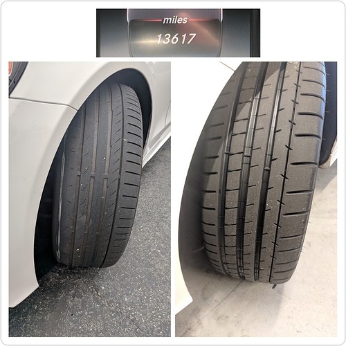

Very similar deal to my C43, you’ll love it. Just be informed that you will likely not get very good tire wear on the front tires (i replaced the fronts at 13k)

How the heck did your tyres get that bad so quickly? I’ve got a GLC43 with 13.5k miles and my tyres still have plenty of tread. With the fronts only getting 31% of the power normally your rears should go well before the fronts. You sure your car isn’t crabbing when on full steering lock as it’s an issue with some of the C/GLC43’s? (Crabbing causes friction on the inside of the tyre so can cause premature wear)
It’s the way the camber is set on the “performance” models, unfortunately there isn’t much you can do about it (yes you can put camber plates on, but are you really going to do this on a leased car…)
But i went with non-run flats, they are much nicer on the road and cost quite a bit less. They are Michelin Pilot Super Sports.
To add onto this, my rears are still at 7/32nds (conti ships with 10/32nds)

With only needing 2, most of the “buy 4, get $100 off” doesnt work, but what i did as bought 4 225/40/19’s and just asked them to mount/balance the fronts
