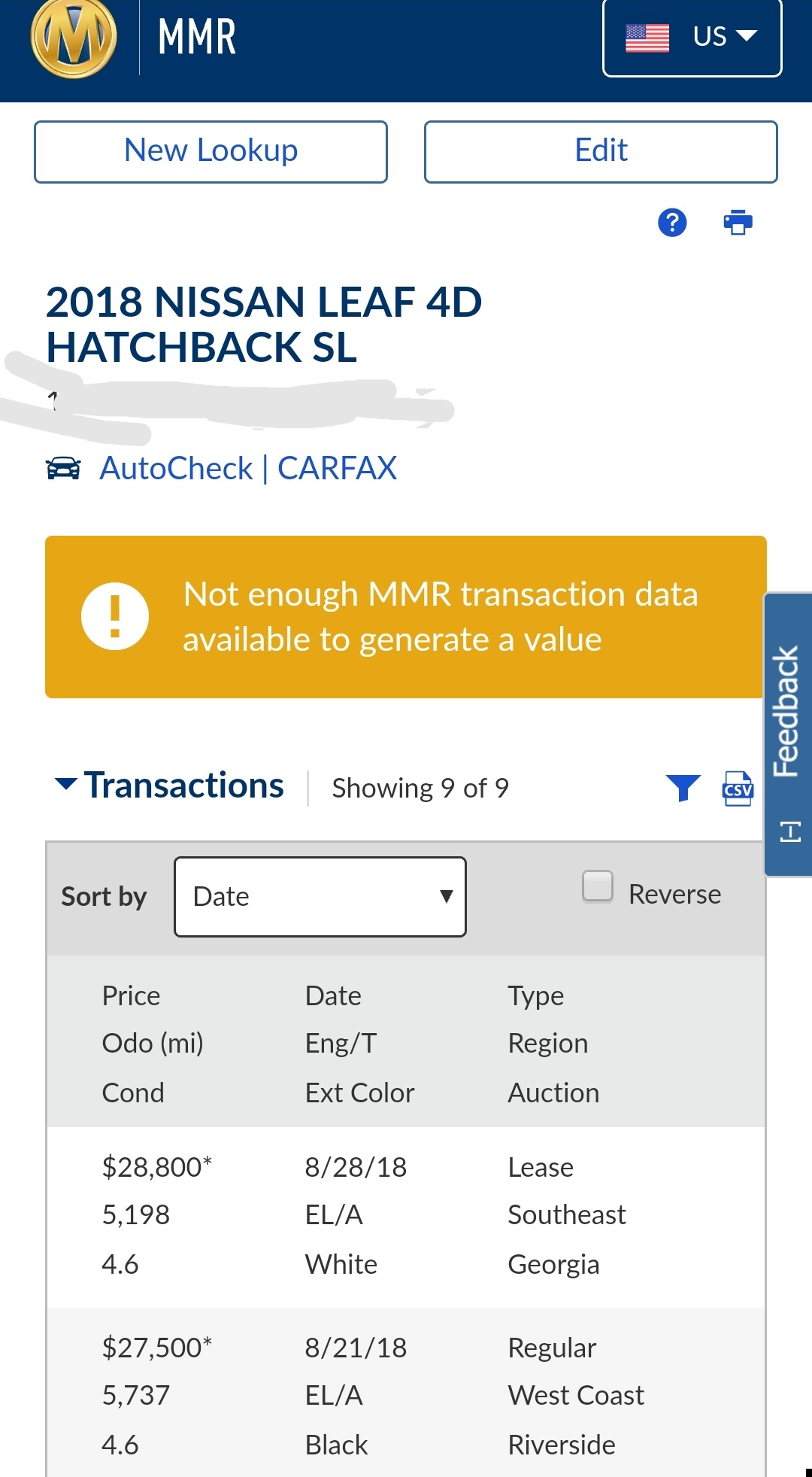

2018 Leaf SL Manheim sales results nationwide…ouch.
The values on the auctions seem high. The 17s I have seen for sale have been 15-17k retail. The 18s do look better and have better range.
The residual the dealer quoted me the other day was 38pct.
The factory cars can be “punched” as a new car thus carry all of the rebates, money factor and Fed Tax credits. These are really highly sought after by the dealers, the 2 non-dealer sale prices on 8/28 and 8/21 are either dealers/wholesalers who had a retail buyer in tow and the RB got auction fever or they have a buyer that made the classic “but MMR says its on the money” mistake. If you can ever get one of these factory cars they lease out super cheap BMW is famous for this their factory lane closed lease cars are screaming deals. I am actually trying to find one of these now and hope one of the brokers on here can source one for me as I am no longer a wholesaler (left a few years ago).
