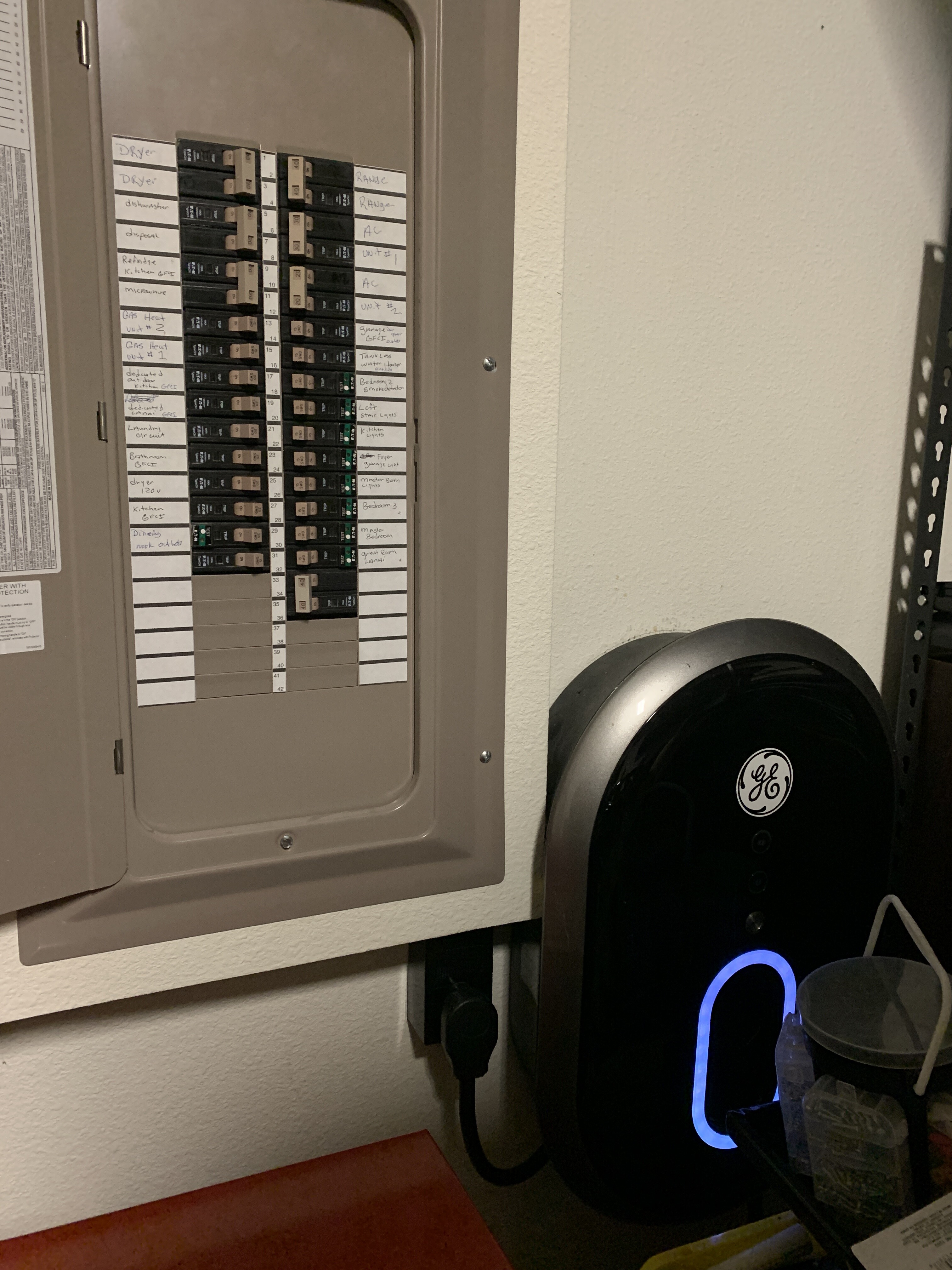

I believe this photo will demonstrate the easiest EVSE installation in the history of the universe😁
The ones I did in our other house before we moved were not as simple, but the premise was the same. There’s just actually conduit length between the panel in the EVSE, LOL
