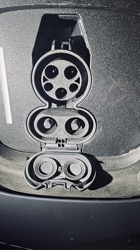

I just ran into this tonight with my eqe 350 sedan. Same thing at electrify America and fused dc. Called roadside and waited a few hours and the guy literally man handled the plug and yanked it out brutally.
The charging port was copper exposing the wires and said that this was fried. You could see it on the ea plug as well.
There’s thread on Reddit. https://www.reddit.com/r/MercedesEQ/s/1X2wSYNMSt
About this.
Going to take it into Mercedes and see what happens.
The tech said they ran into this with ea but not with others charepoint / tesla.
It’s unfortunate because I have 2 years feee charging but only at ea.
If you look at the right side, you can see the residue.
