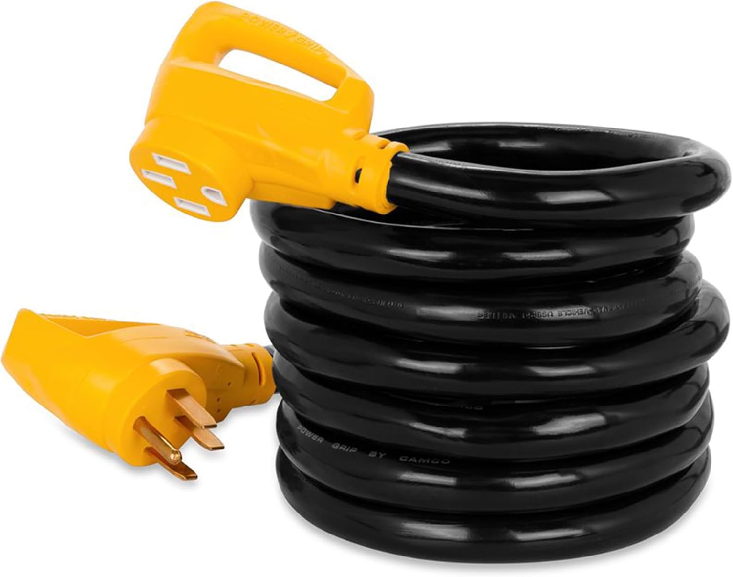

I discovered that the plug had MELTED. I’ve been using an extension cord for my EV charger for 8 years and never had an issue…until now.
I don’t know if the issue was caused by the extension cord or the Juicebox. I do know that the end of the cord was burnt and the Juicebox charger plug was melted.

Just wondering, were you extending in on 110? If so, the Orange HD cords aren’t rated for high amps, you needed to get the higher rated ones like the ‘red colored’ cord.

The cable was designed for RVs and is rated to safely handle the Juicebox.
The master electrician I used in 2016 said the cable should be fine.
So basically imported Chinese crap. Thanks for clarifying
6500+ reviews with 4.8 rating. And frequently used by RV owners.

Extension cords with EV charges are not a great idea. Neither are cheap outlets when you’re running 40 amps through them 6 hours straight.

The female end of the extension cord melted to the male end of the Juicebox cord.
I don’t know the brand of the outlet. I plugged the extension cord into the wall outlet in 2016 and didn’t unplug it until today.

“WARNING: Do not use this device with an extension cord.”

It’s never a good sign when one part of the listing says its only rated to 125V/3750 W and a different part says 12500 W. Keeping in mind that a 50amp rated circuit is only rated for a sustained 9600 W.
I also like how their graphic for 14-50 is the wrong plug.
When a non-UL listed electrical component cant get its ratings right or consistent, it’s a good indicator a fire is on your future.
