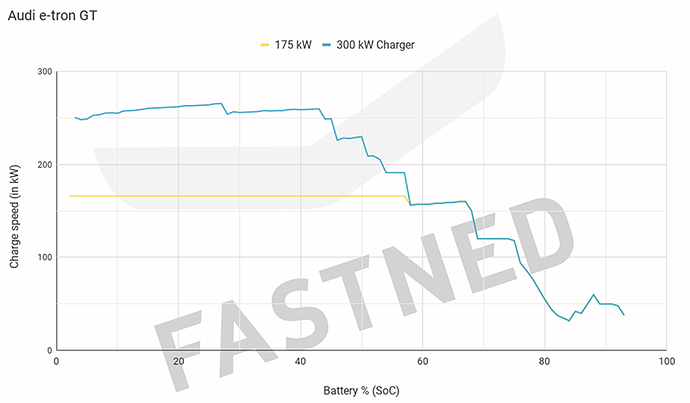

I set it as a destination in the car nav, that’s the only thing you can do it seems.
That works on some. What model is it?
RS Etron GT
Nice. I’ve been thinking about one of those as my next car.
Don’t have any direct experience with the e-tron GT. The internet seems mixed as to whether setting a DCFC as destination is enough or if it needs to know it is a charging stop. You probably know more about that than me.
Do you have any direct way to measure either battery temperature or battery discharge rate? If it is preconditioning you should see a higher discharge rate.
Properly conditioned your car should be able to start right away at 250 kW.
But what you are describing sounds like what people see when the battery is not in optimal temperature range.

I’ve tried different chargers at the same station, different starting SoCs, etc, the only thing I can think of is that the battery is not pre-conditioned, but there’s no way to tell whether it has or has not done so or how long it takes. Does driving 10 miles get you up to temp? 30? 100?. I wish these things just came with a switch on the dash that you can just flip to “precondition”.
I agree that car makers should make this easier instead of abstracting away the information.
Ideal battery temperature for charging is in the 60 to 90 range. If it is 0 degrees outside the system might never be able to get the battery to 60. If it is 30-40 degrees outside the system might take 30-60 minutes to get there.
The best time to really test your charge speed might be spring when your battery can soak in ambiant temperature in the 60s, and then accept that winter DCFC is a compromise.
As an FYI - EQS does display the maximum DCFC speed based on the current battery temperature. But I agree most do not. Ford doesnt even preheat.
