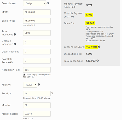

Can someone make sense of this for me? I put all the numbers through the calculator and its just not adding up. Or maybe its me…
Rv is supposed to be 64% with .00130 MF
This is with LA tax at 8.75%. Don’t know what your state is.
6% lol so yeah I’m not getting the math here
That makes the residual 53%
Where did you get 64%?
Also, most of your quote is a purchase quote.
64% sounds right for that car, unless they have tanked today which is effectively the 1st of the month because of the 4th July.
I’m going by the information that was posted, which looks like it was copied and pasted from a dealer quote.
I got that RV from another dealer in the same area about 12 hours ago lol
I don’t think I’d ever lease a car with a RV of 50% when the MSRP is 45-50k (with all the options that I want)
Different dealers might be giving you quotes with different banks, which would have different RV/MF.
Thanks guys. I wish ally or usbank had any sweet incentives going on
If it’s CPO the RV is going to be lower.
