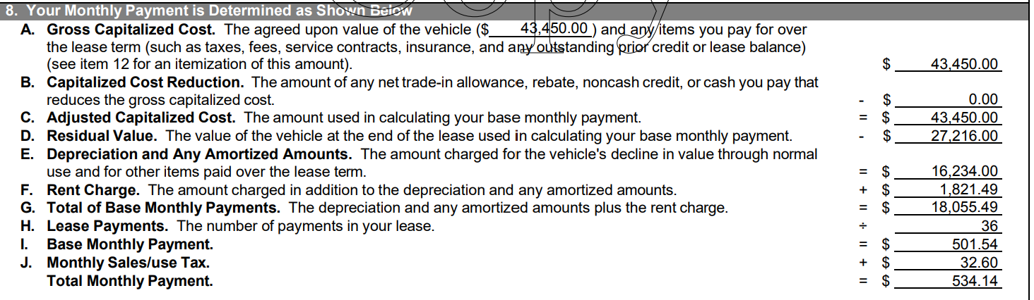

So at this point, I wanted to check with experts here, why did the ‘discount’ only resulted in a miniscule reduction in monthly? Did they may be gave me lower RV for a demo? I am attaching 2 screenshots for the first lease estimate and the later.
Also, will the price reduction of $2680 be considered a discount on MSRP or will it just be a lower MSRP? Asking because I am not sure how Tesla does this. If discount, the monthly (or total cost) should be much lower I would imagine. But, I ‘think’ even with reduced MSRP, the monthly (or total cost) should still be lower than what they are quoting.

Original quote: Cost over 36 months $20,986.42
Demo quote: Cost over 36 months $20,711.98
Most likely yes
I noticed this while browsing inventory. The lease numbers on demo units aren’t really any cheaper. I suspect Tesla is lowering the RV but who knows since their lease numbers are a black box.
Since, with Tesla, you cannot actually pay the RV and own the car at the of the lease, there’s really no benefit to leasing a demo vs a new unit. Only maybe makes sense if purchasing.

I know what you mean. But… even their pre-tax/fee estimate yield bigger reduction than $7. So not sure what’s off.

Proceeded to pick a delivery date. Uploaded insurance details. This led to a bunch of documents available to view.
The lease agreement now shows that RV on this demo seems to be about 62.5% vs 65ish% for a new car. Hence the miniscule reduction in total cost.
I texted back saying I don’t want this and to assign next available new car.
Not worth getting 3k miles demo for $200 reduction in total 3 year cost.
